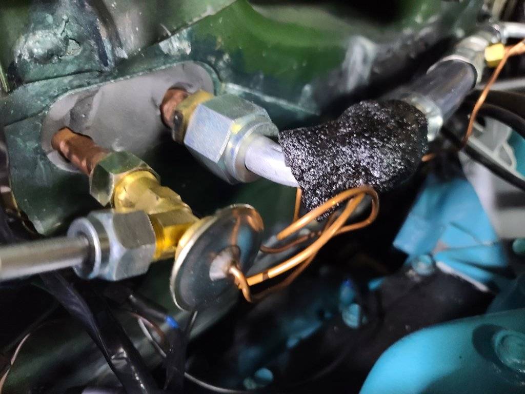

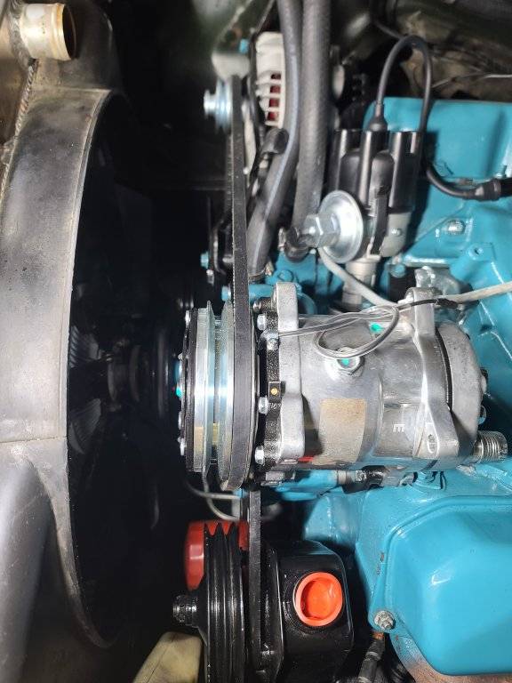

I ended up keeping the original Condenser and Evaporator and went with the Sanden compressor, new drier, lines etc. 100+ degrees out and it blows pretty darned cold given how old the system design is.
I lucked out that both my cond and Evap were in good shape though. Flush them, and flush them more.
Bouchillon Performance has all the parts you need to do this (including brackets) and the price won't break the bank. The only hard part is crimping the lines. If you want to DIY those you can get a hydraulic crimper off Amazon for around 100 bucks.
how many cans of flush did it take to clean out the condenser?
I am in the end stages of a conversion. I did everything a la cart. It took allot of effort. Mostly got parts via Ebay e.g compressor, evaporator, expansion value, Condenser... I used a place called Cold Hose for hoses and fittings. Don't buy fittings from Ebay. They're made poorly.
