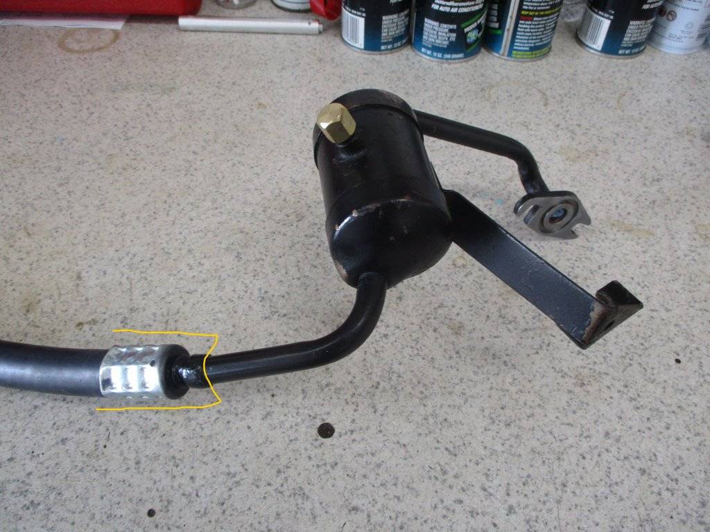

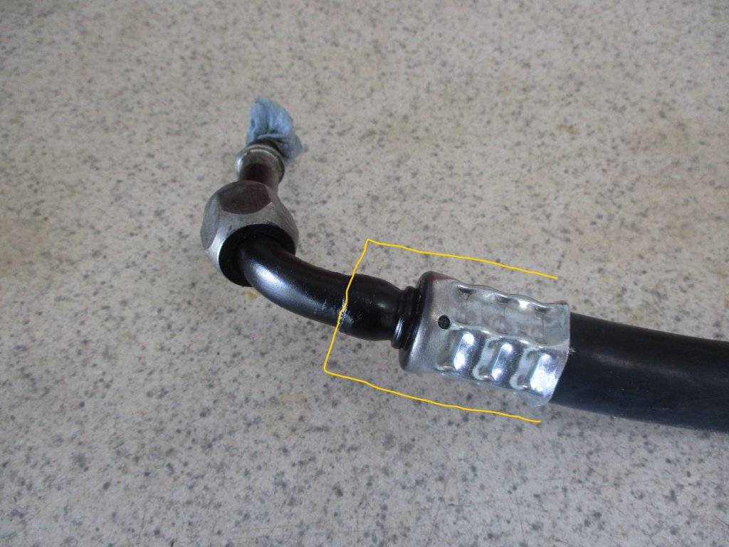

Just to further explain, here's both ends of my "new" old discharge hose. The shop removes the existing brazed on crimp fitting (ferrule) and brazes on a new one (everything inside the yellow markings in the pics below), and then crimps that onto a new hose. So again, if you have just about ANY discharge hose from a junkyard that has the two necessary ends, a shop can make you a new one. The configuration of the bracket and the muffler certainly varies by car and engine, but having a muffler isn't mandatory for the operation of getting cold air. It's there to dampen the pulsations/noise of the Freon coming out of the compressor. But having a bracket to support the hose near the compressor is very important, so try to find something that has the bracket and points in the general direction that you want the hose to go.

Condenser end: [Both ends have been repainted after the brazing/crimping operation. I choose to leave the crimps unpainted just like my original suction side hose assemblies]
Compressor end:
