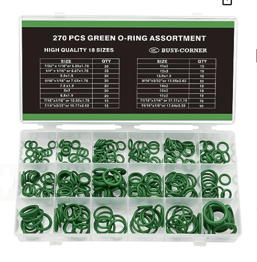

So, for you, that means buying an SAE automotive AC o-ring kit, containing maybe 20 of each possible size. That's what I did. $9 at Amazon and probably at your nearby auto parts store (but make sure it's SAE!)
I am not sure of the hose seal sizes but I just picked up a box of various sizes green o-rings, that I found at the parts store.

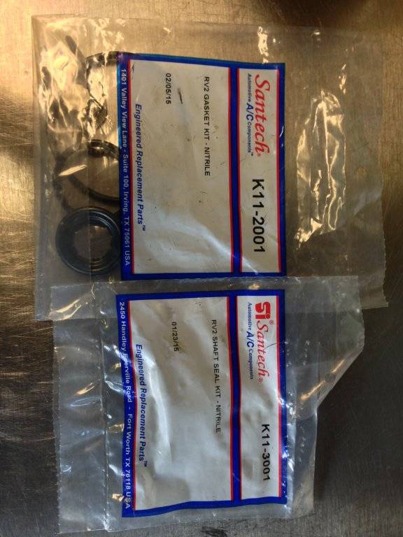

Besides that, the rest of the gaskets and seals deal with the compressor:

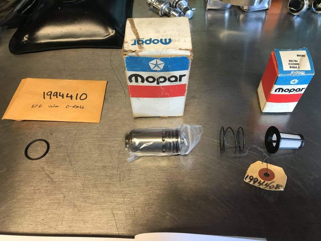

- gasket kit (heads, rear suction inlet at EPR valve, front outlet).
- front seal kit, these are sold separately from my experience.
- EPR valve seal (if keeping R12) - see below
Thanks for the info. I may buy a master seal kit SAE, then what I don't use donate to my old school AC shop. They have been helpful with other projects this year.

Were you able to replace all your O rings with that kit?
Exactly what I had to do....chip away at finding the various seals and gaskets that are directly involved with the compressor. They're out there, but you gotta search. The hose o-rings are the easy part.

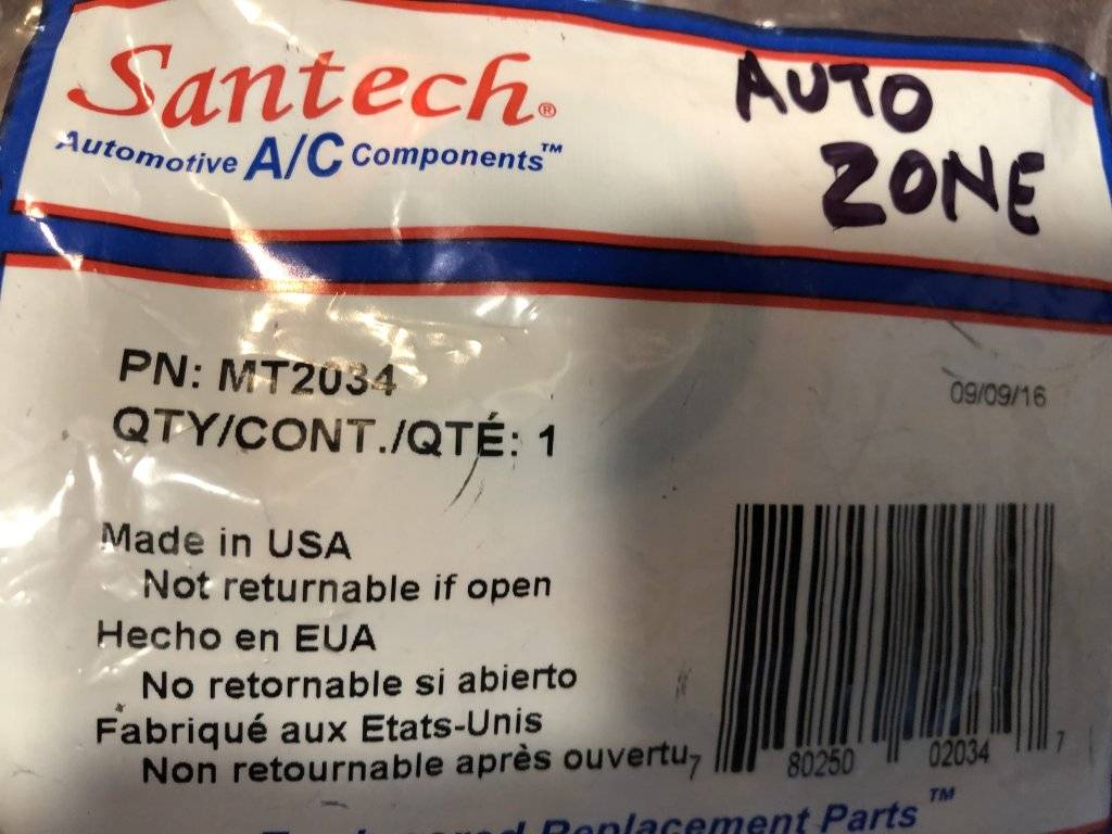

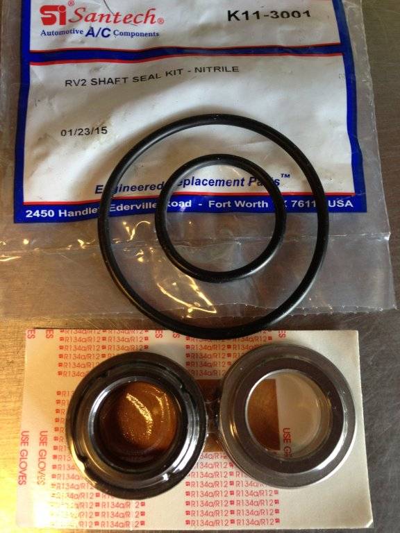

Here's the ceramic (front) crank seal kit (all the seals behind the clutch), $20-30, ordered from Auto Zone.

Thats a good looking assortment of parts.
This is my first foray into AC resealing. Thanks again all for the help.
Interesting - different p/n than the same one that I used. Looks like the one you used might have been packaged for export...?
