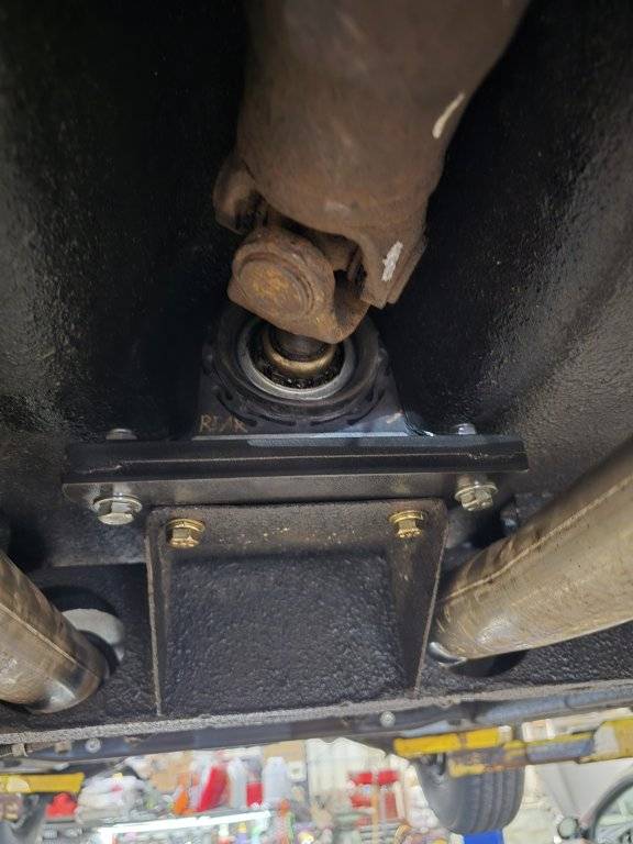

I got around to finally checking out the driveshaft and the carrier bearing. It most definitely is the carrier bearing. There is about 1/2" of play in the rubber "donut" in the bearing housing. All the other components seem tight. So, my first guess was right. As far a fixing it, I am going to try using some modern parts and a homemade adapter plate as a first option. Then, I can have the other one sent out and rebuilt. Unless someone happens to have a spare center carrier bearing (good or bad needing a rebuild) for a '58 Imperial that has a standard non-x-member frame (2-door Hardtop or 4-door sedan)?
And, it's fixed! After talking with someone on the Imperial Mailing List site, I found out there is an aftermarket carrier bearing assembly that can be slightly modified and used with a custom made conversion plate to be used as a substitute. The person I talked to used this to convert his '58 Imperial 4-door Hardtop (which has a large X-member frame). Some said there were a couple different carrier bearings made, depending on whether the model had this X-frame or not. From everything I read, there was only one type of carrier bearing made for all '58 Imperials This kind of proves that. My '58 is a 2-door hardtop and does not have the X-member frame. Still, this same conversion plate worked perfectly in terms of height and offset.
P.S.: I was going to get the original bearing fixed professionally by sending it off, and using it as a backup. However, after noting how much more robust this conversion is, forget that!
