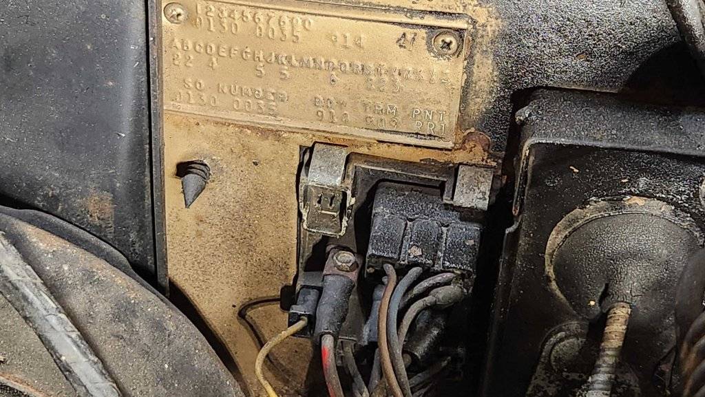

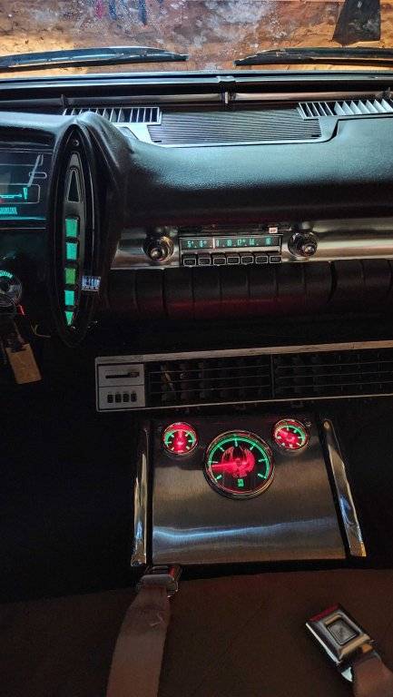

I added a tachometer to my '63, trying to copy the style of a 300 from the same year. I needed to run a signal wire from the tach to the coil. While looking at the main wiring connector in the engine bay, I realized the empty port that would have been used by the AutoPilot wiring looked like a standard Packard/Delphi 3-prong connector. I took a connector from my American Autowire kit (which I highly recommend if you own one of these cars) and it fit perfectly!

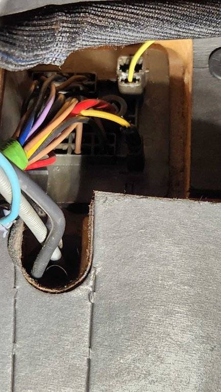

- Pushed a male Packard 56 terminal through from behind the dash. The socket in the bulkhead connector is set up to accept it, but I did need to poke through the thin plastic with a pocket knife to open the hole.

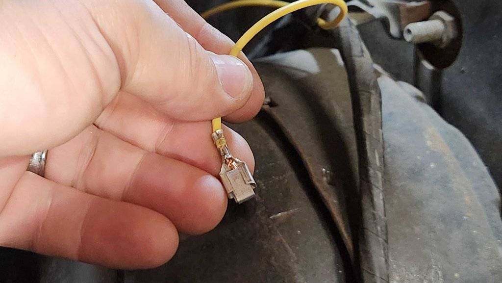

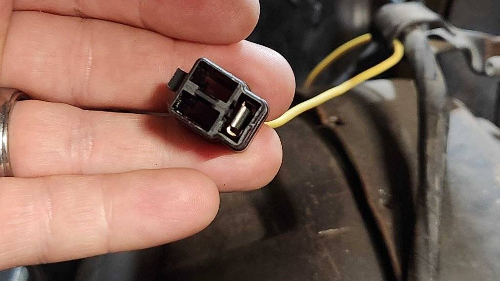

- In the engine bay, ran a female Packard 56 terminal though a female 3-prong connector

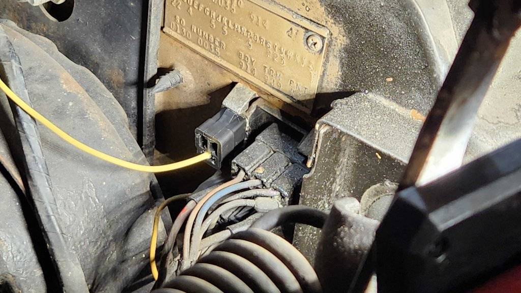

- Pushed the female connector into the bulkhead connector. It was a very snug fit, but I suppose that's a good thing.
- (Not pictured) ran the tach wire along the same path as the oil pressure sensor and alternator wiring to the coil
