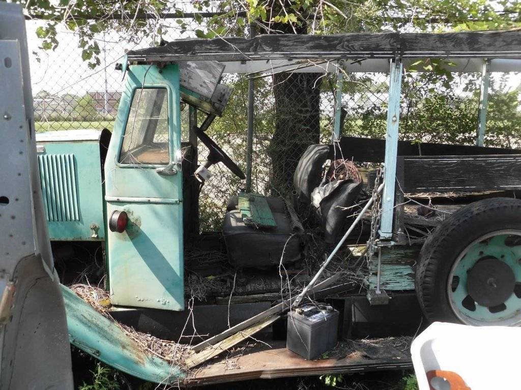

I finally figured out how, as a carpenter, to make money restoring a car or in this case a truck.
I've been waiting to post anything on this until I was sure I clinched the whole job. It looks as though my work in phase 1 has done just that. I thought some of you would find this interesting.
For starters about the truck. It is a 1934 REO Speed Wagon that has been sitting in the weeds in a backlot locally since the mid '70s at least.
More to come.

Not mine, didn't you see where I said I will actually be making money on a restoration???:D
That is cool, was it a work truck, or some sort of sightseeing or troop unit?
Pretty sure it started out as a work truck but towards the end of its previous useful life I think it served lighter duties. It's staying in the family and will likely be used as a marketing tool for the business and see parade use, shows etc.. it likely isn't geared for anything not local.
That will be interesting to restore!

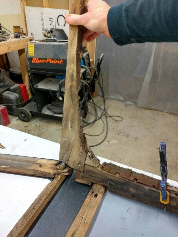

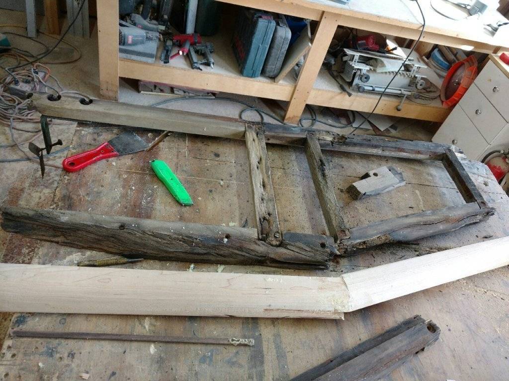

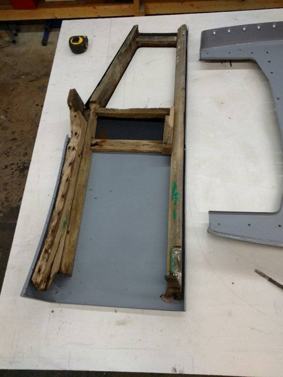

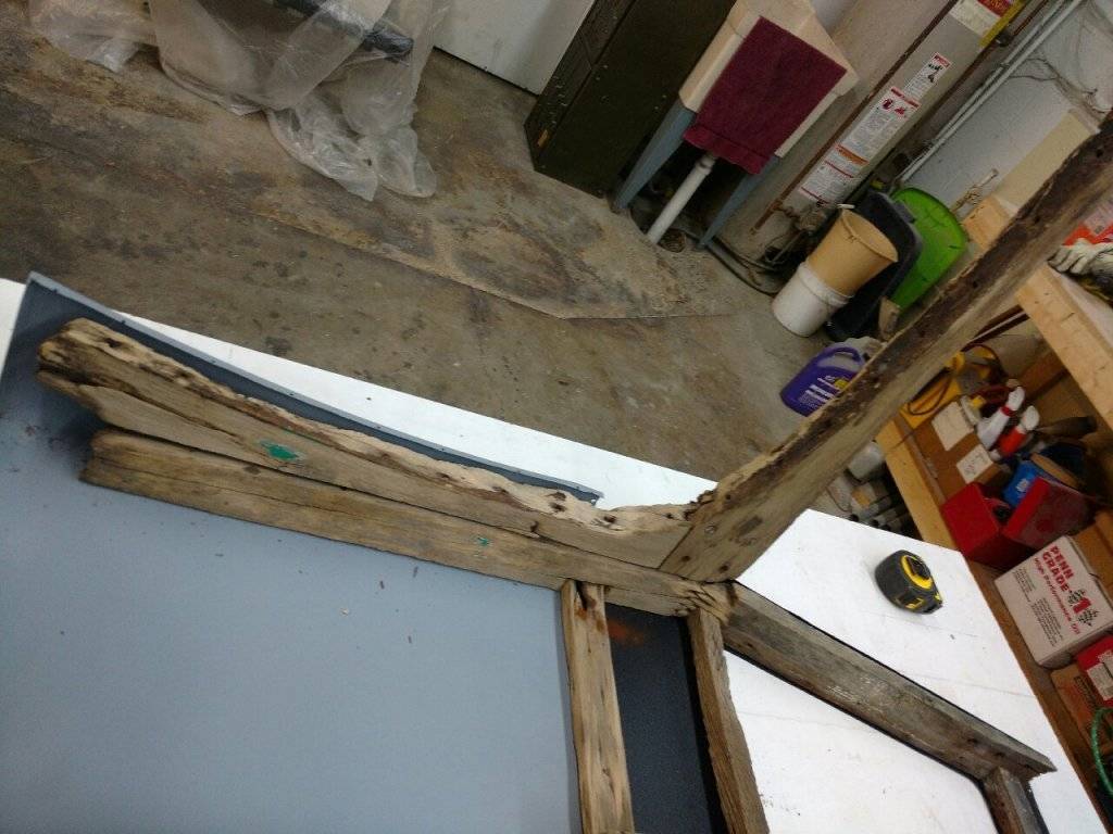

Phase 1 is replacing all of the badly rotted wood framing that the metal body panels are attached to with nails originally. I was given what was left of the wood and the metal skin which had already undergone restoration. Here's what I started with. It seems sometime in the distant past that a couple of pieces of the wood were replaced with a standard dimensional pine 2 x 4 but the rest appears to be the original maple. There aren't many pieces involved in this phase but most of them are very complicated with a profile that changes from one end to the other.
