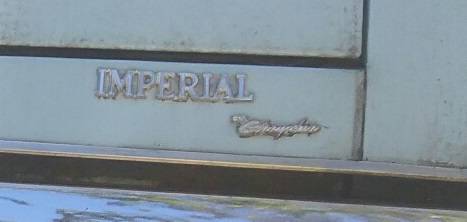

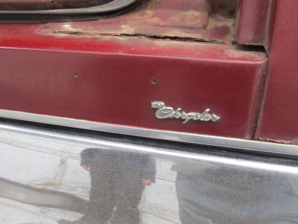

What kind of adhesive would you recommend for adhering emblems that do not have pins or screws?...see pics from donor vehicle...manufacturers and dealerships must have a very reliable product when retention of a plate or emblem is reliant on just the adhesive properties. Not sure if local hardware will suffice with options...something really strong
out there?

#3612864 "By Chrysler" trunk nameplate 1971-1981
have 11 of these NOS in case you need one
Hello...do you have the top IMPERIAL lettering, too? If not Murray Park might...I just haven't got around to inquiring...on my list to do. But, I would gladly buy one "By Chrysler" from you. Thanks.
