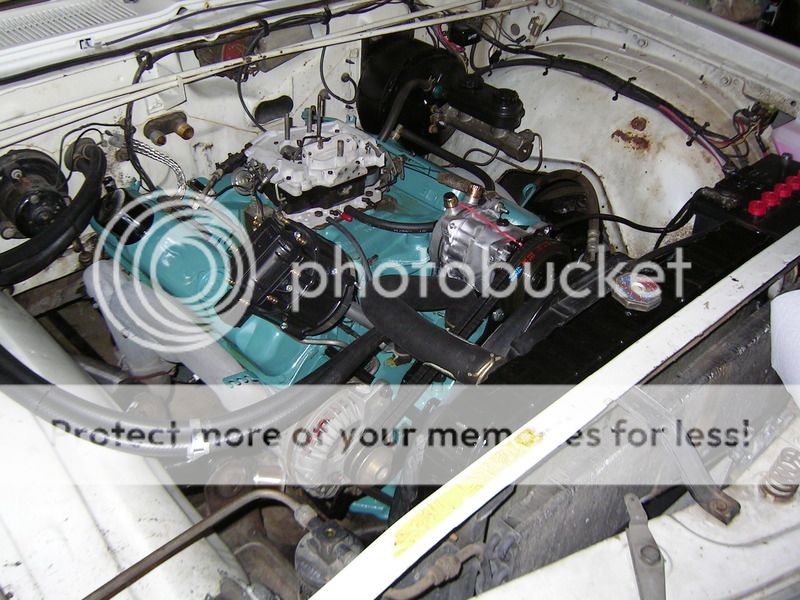

I had a converted HEI dizzy on my 360 in my 70 Sport fury years ago...worked like a charm, and I never had any issue. Didn't mind it on the small block because it was hidden at the back of the motor. I did buy a brand new HEI dizzy for my 440 in the wagon, but popped it in the hole and realized right away that it just looked "Wrong"! So it's been in the box for at least 5 years now.
