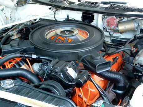

The above housing doesn't have the indentation to clear the A/C compressor like the single snorkel.
Will the above shown still fit an A/C equipped engine?

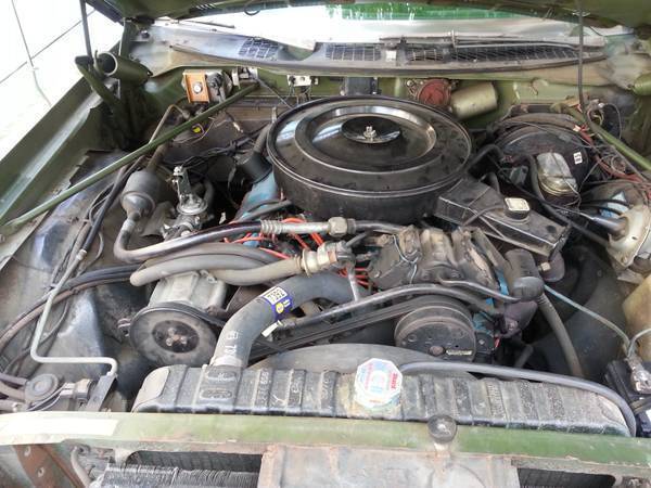

Which also leads to the question, was a motor home compressor mounted differently than a passenger car? I can't remember ever seeing one mounted on a 440 other than top left of engine.aa.jpg

Was the housing, pictured in the first post , when it was used on, let's say a 1970 Chrysler 300 with a 440, if that 440 Chrysler 300 was equipped with A/C?
I would say no. The housing in question has the air inlets at 5 and 7 oclockish. The passenger car is more like 4 and 8 oclock.
I am no expert on air cleaners. However, my gut feeling tells me the reduced angle between the snorkels would probably pose a problem clearing the A/C hose that comes out the rear of the compressor.
