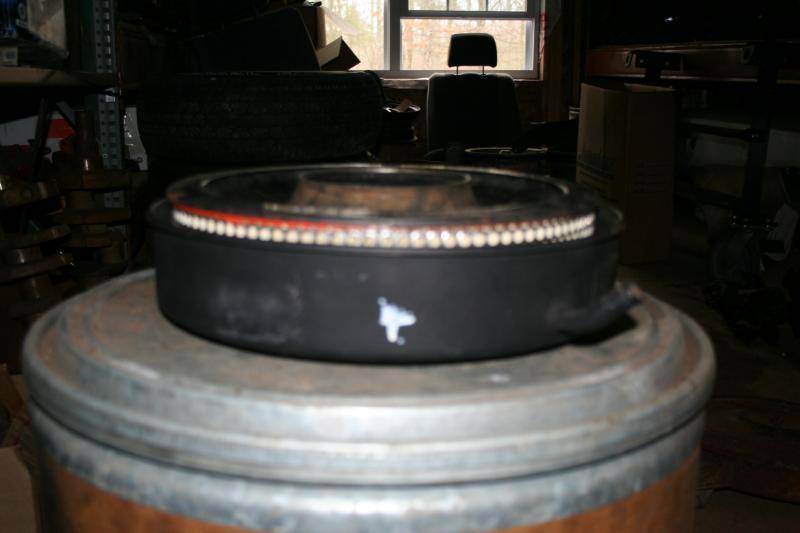

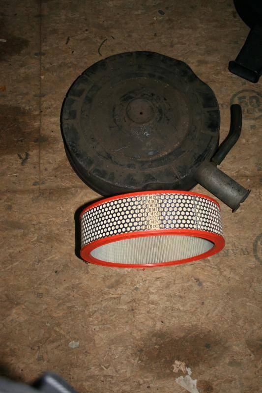

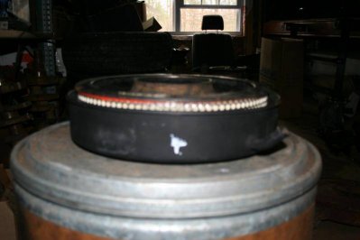

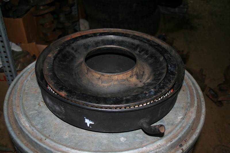

I have a friend that has both types of air filters, I'll check to see if there's a fitment issue between air cleaners and filters.

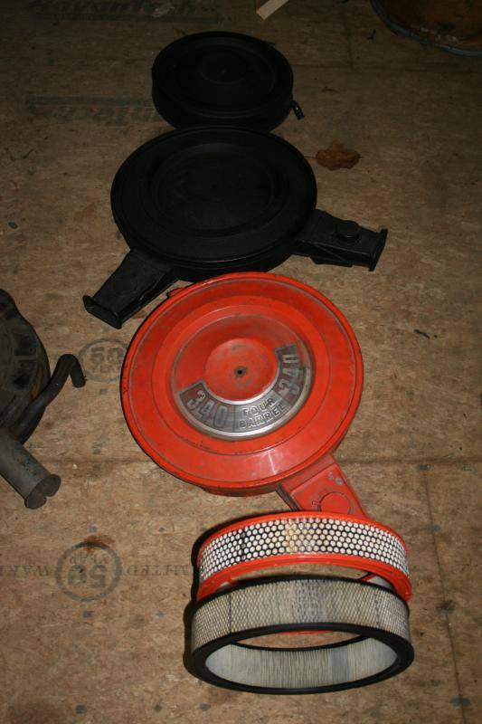

Some photo's of air filters and air cleaners, the orange filter and the black are the same in size. The larger orange air filter seems to fit the early style air cleaner so I'm not sure why it's listed in my 72 parts book. Sorry about the quality it was dark and cold in the storage area.air filter charger 012.jpgair filter charger 013.jpgair filter charger 016.jpgair filter charger 017.jpg

Last two photo's of un silenced air cleaner first with the larger early style filter the last with the later style Fram filter.
