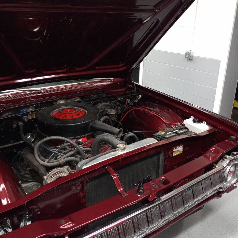

Just ordered a 68 spec dual snorkel air cleaner for my 68, 300 and I need to get a filter for it. Rock auto has a 3-1/2” and 2-3/4” tall filter which one would I need? Or if someone has a part number that would be even better.
-Thanks
Josh
Dual snorkel tales the same element as the single snorkel. Fram CA-127 should do it for the filters where there is a separate base plate and a "top" which covers it all. Same filter as the '68 Road Runner 383 4bbl open element air cleaner.
When the filter cases changed to a separate top plate, the numbers changed to a shorter element.
I run the K& N filter. Readily available and the last filter you ever need to buy.
Washable and reusable.
