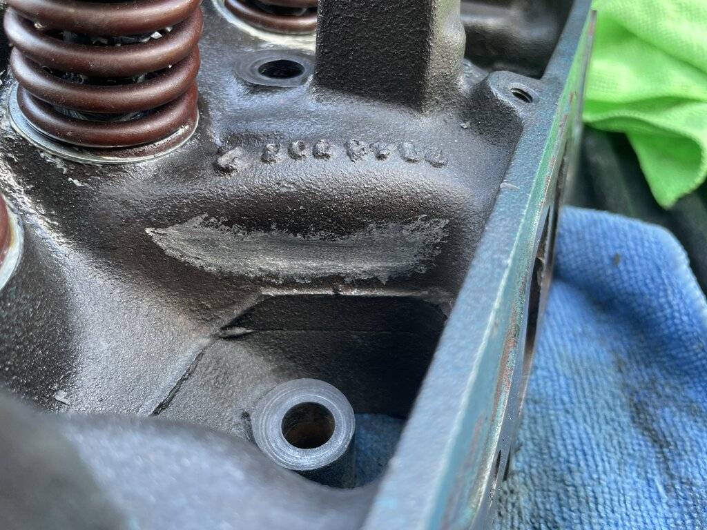

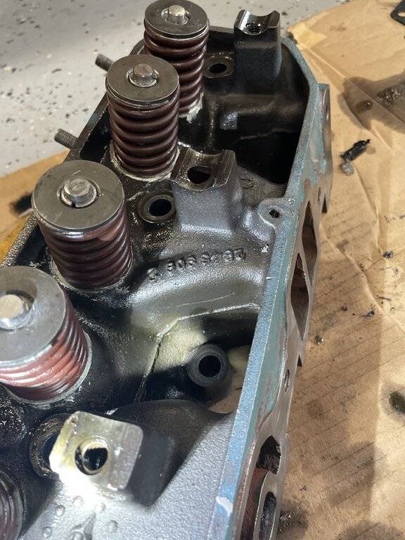

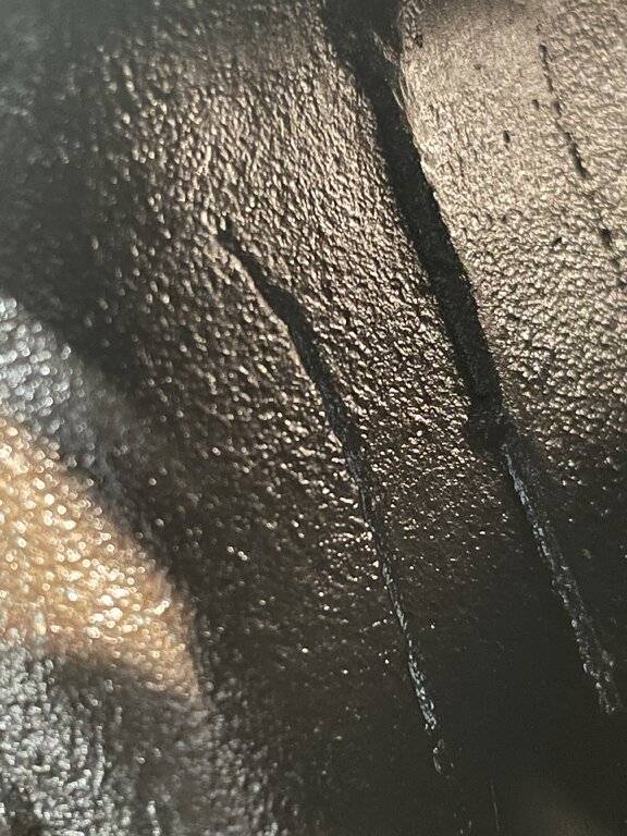

Yeah there out of stock till end of June. I found a crack in my stock head.

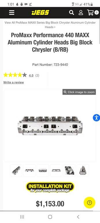

I have Promaxx aluminum heads with straight plugs on mine with stock manifolds.
Jeg's has different levels from $1150 to $2000 a pair assembled. I'm pretty happy with mine.

Are you sure that is not just a casting flaw? What does that side of the intake port look like?
Kevin
Yea, that doesn't look like a crack to me either. Of course, that's based on the picture, but I would be surprised if it was.
