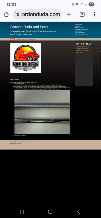

We have a local guy by the name Gordon Duda who is retired and does trim restoring full time on the side. He does excellent work and reasonably priced.
