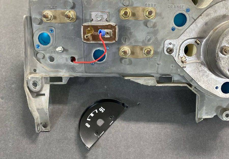

This I've found to be NOT so. I run my analogue d'Arsonval gauge voltmeters off the switched bus in the fuse box. When the alternator charges, the bus voltage zips up to 14.5 VDC, instead of ~12.5 normal to a good battery under minimal load. I've found in the 5 years I ran this setup on Mathilda that a 60A alternator, when charging the lead-acid battery I run, produces a +2VDC rise above the battery base line.
As soon as that alternator cut out, the drop showed instantly.
