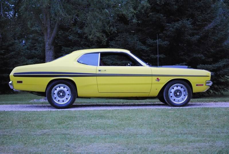

Not personally, but many people are running larger-size LX rims on all sorts of older Mopars. These are 17" cop steelies painted Argent and running rally centers.
