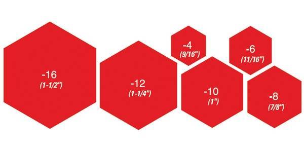

AN fitting chart

commonly used in aircraft & race cars
Very helpful to have these wrenches made for the soft AN fittings. If you don't have the correct wrench & I don't just wrap the fitting with one layer of household masking tape. Still be carefull. Tighten slowly then remove tape & fitting should be fine
