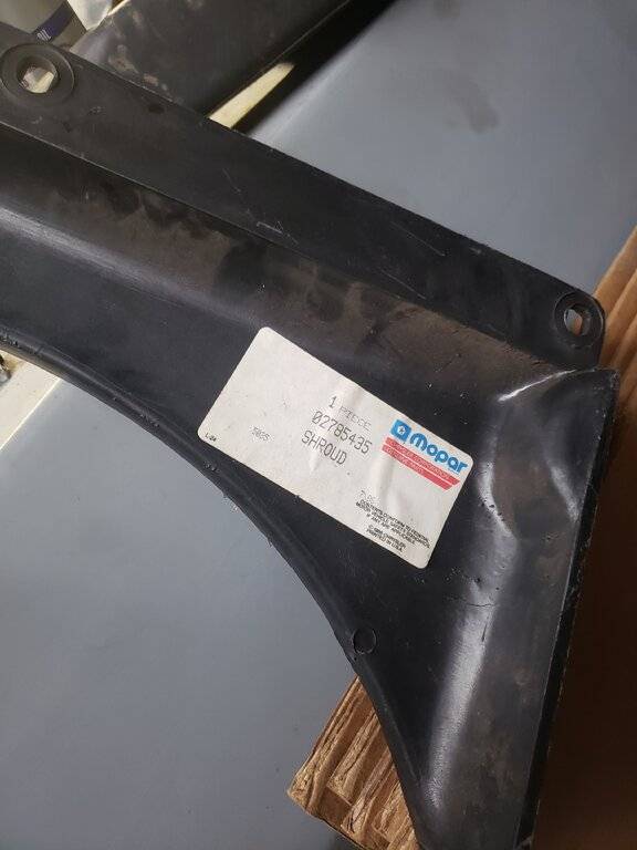

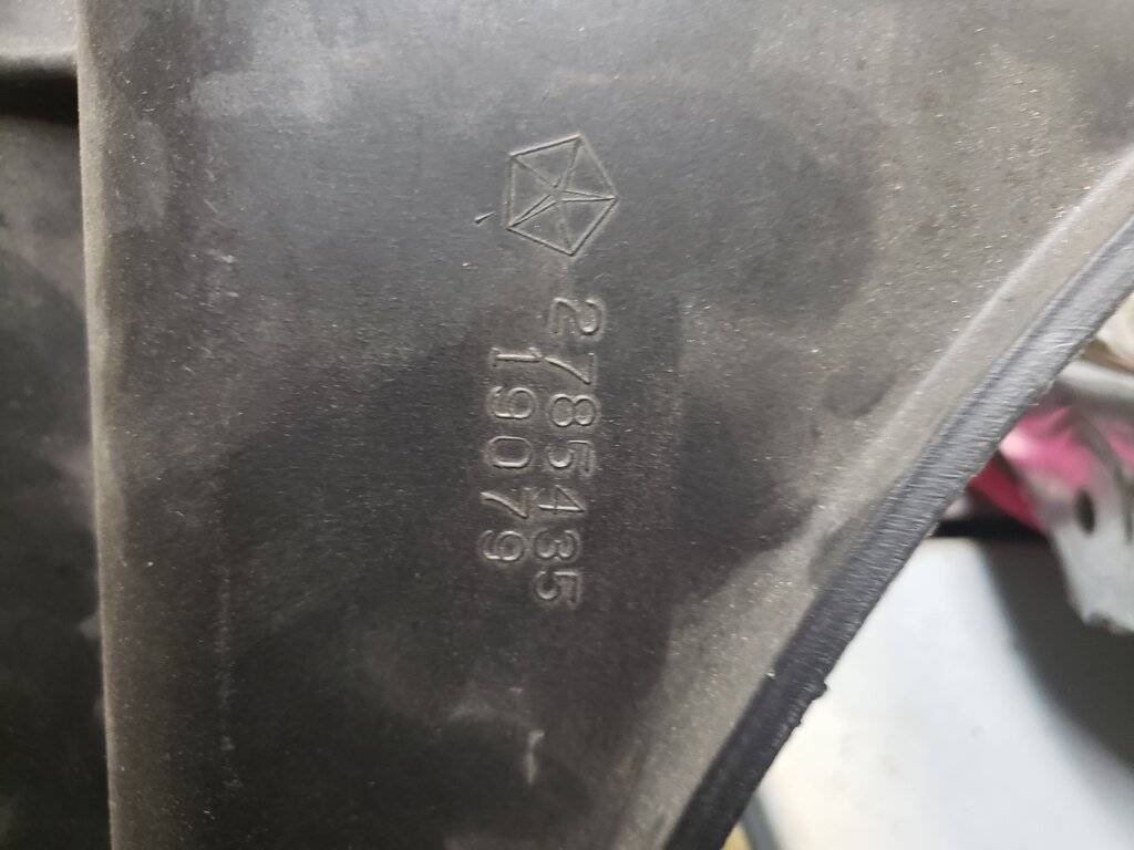

I do have a NOS 26 shroud
David, Manny's NOS one is your best bet.

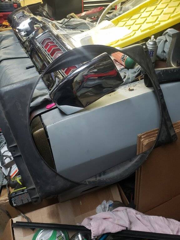

Given the time constraint for the show, Im afraid the used shroud I have will not get to you on time.
Manny is closer to you and given the quality of your car the NOS would be best.

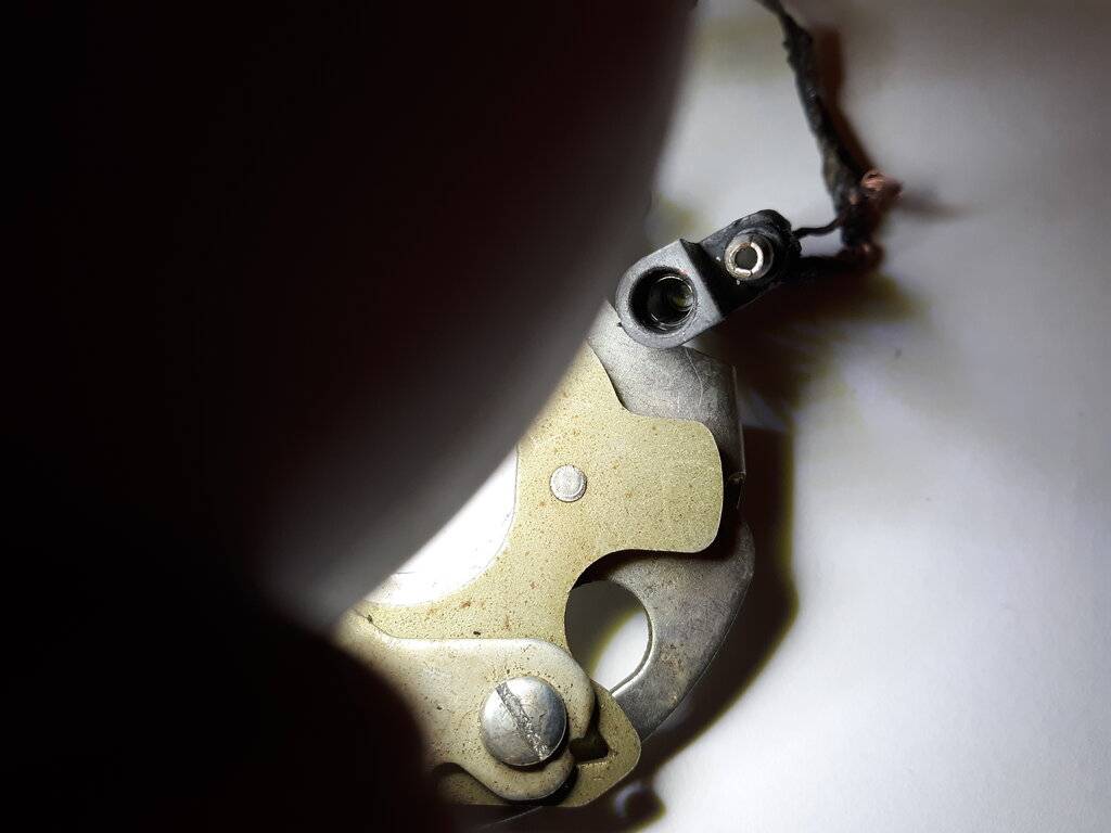

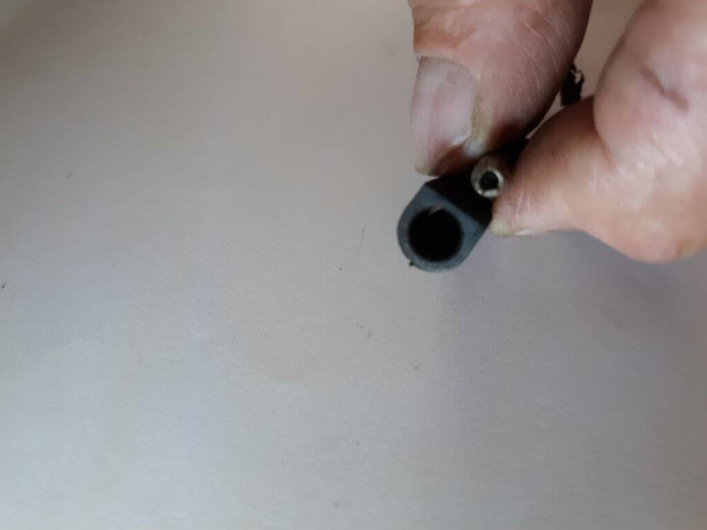

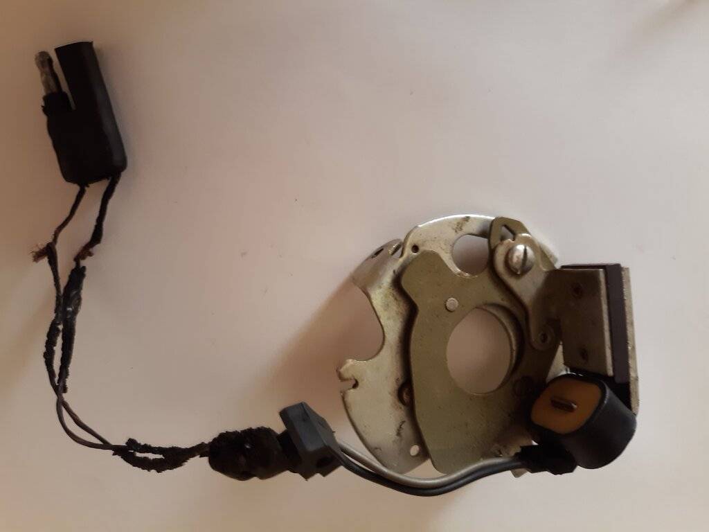

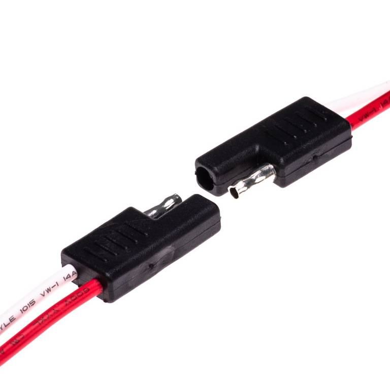

I am Having problems w/ finding a dist. pick up for my 300. At no surprise the manufacturer quality found is pretty bad to NFG. Example, Standard Ignition pickup are made in China w/ not worth a crap quality. The exact problem none will plug into my engine harness. What is currently being offered the rubber shoulder is shorter than the original OEM. It leaves the terminals w/o enough depth to clip together, see pics below. Does anyone have a proven source for correct parts and part #'s. I would settle for a use good pickup as Ocala is a little over a week away.

I’d check with @halifaxhops…
