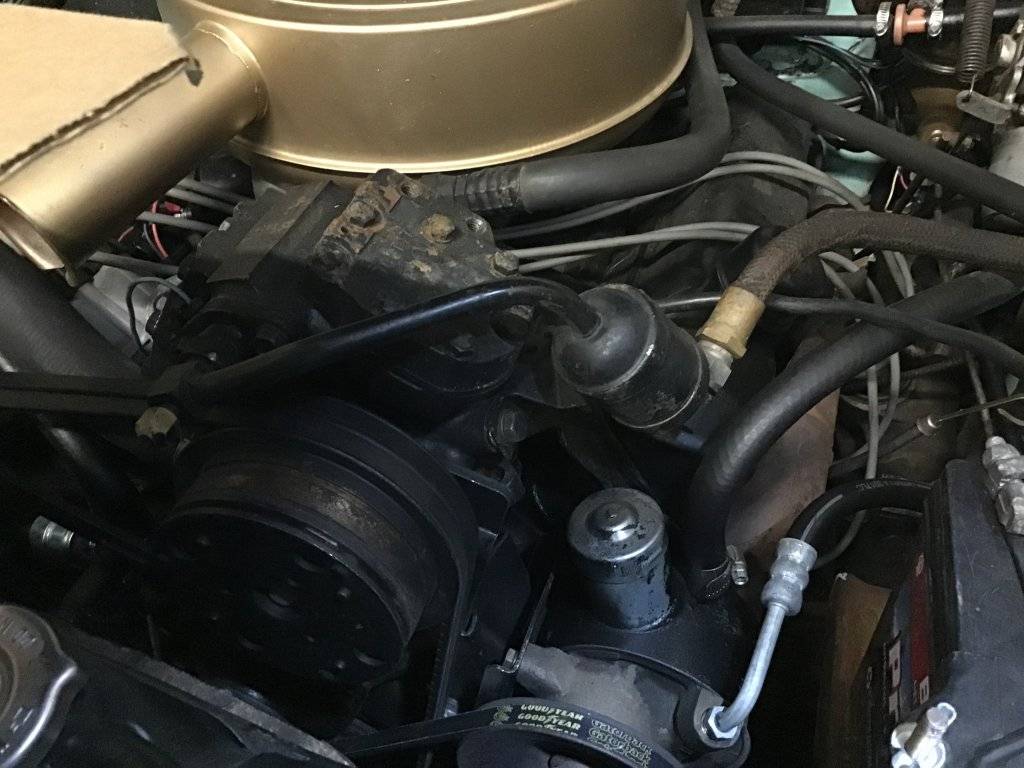

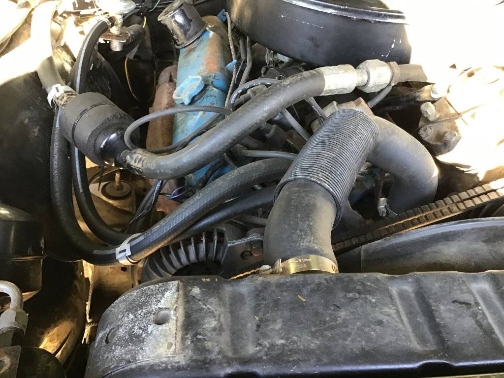

Here is a 1970 440
Notice the alt and AC brackets and how low the alternator is compared to valve cover.

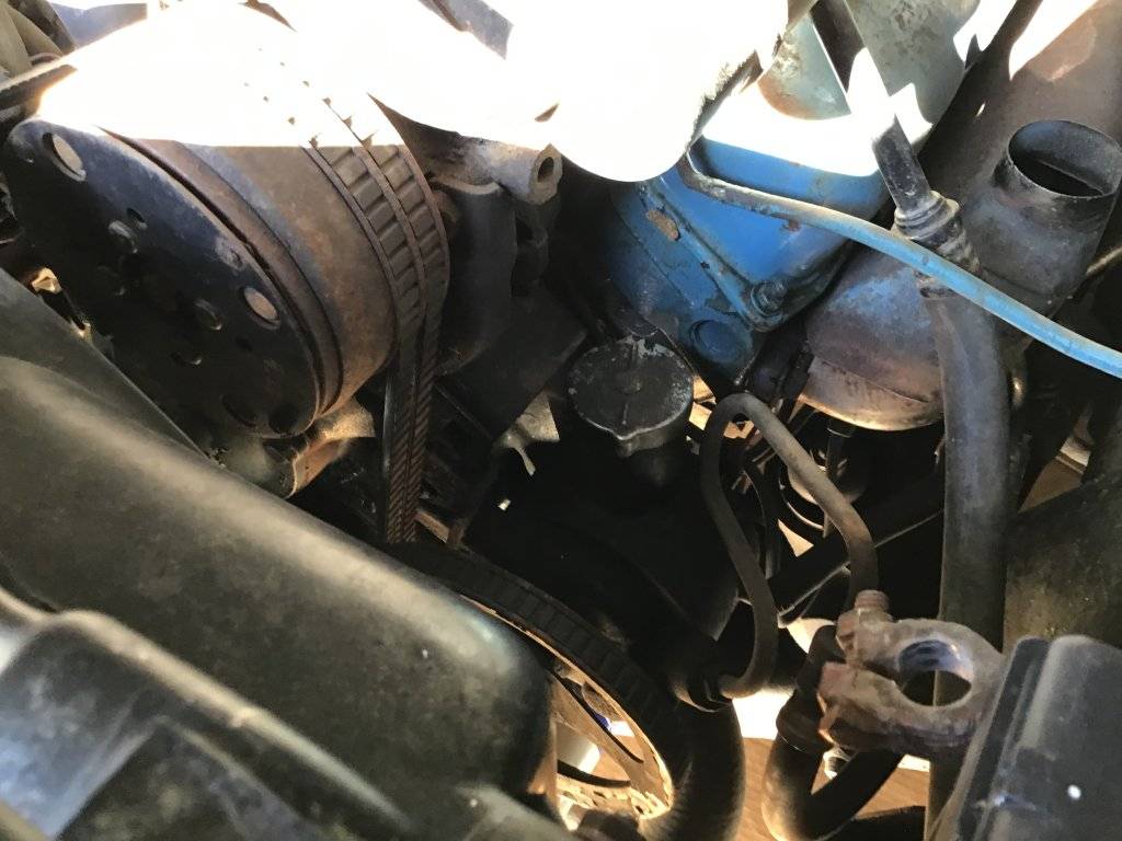

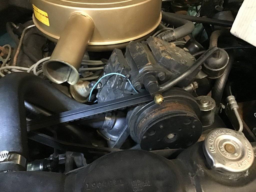

This is 1961 413
Notice the alternator is way higher than valve cover and is upside down. The Ac. Compressor is tilted and further to center so the angled water neck is needed here.

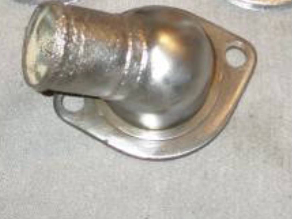

I think I have an aftermarket aluminum angled housing/waterneck/elbow that I would sell.
Here is a 1970 440
Thanks for those pictures! very helpful
This is 1961 413
