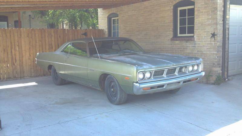

Hello friends I hail from the ForAbodiesOnly forum (MOPEkidD-3), I have a 1970 Plymouth Duster that is my project I have owned for 7 years and now I've finally got my hands on a C-body. I was looking for a car to fix up and flip for the summer and came across this badass '69 Polara 2-door... Not the easiest car to sell (to put it lightly) but it has some really cool features and the mechanicals are in great shape.
It has a factory 383 4-bbl which for this year had 10:1 compression (advertised). Also 727 trans but that's a given with these cars lol. 8 3/4 rear with 3.23 gears and sure-grip to boot. Has a new dual exhaust Other options include A/C, power steering, power drum (!!) brakes, and the super cool "Super-Lite" which currently has a burned bulb I suspect. I could surely use some help from here as I'm unfamiliar with some of the smaller gizmos the C-bodies are equipped with. I want to get it in good driving condition as it currently needs a front end rebuild, few brake parts and some engine accessories (just put on new starter, needs new alternator).
Welcome to the forum and thanks for the pic. You have more / interior shots and what is a "super cool "Super-Lite""? Is it the thing on the drivers side of the grill, inboard of the headlights?
Yes, thats a super lite, two year only option.

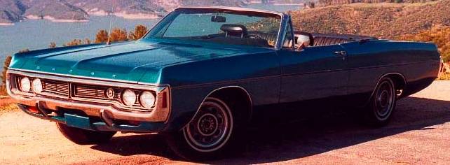

That is super cool dusted. Here's one on a 70 model
Also exceptionally rare for 1970 was the "medallion" rear bumper. This bumper featured in all of the sales literature was discontinued after late August or early September 1969 production and replaced with a plain bumper lacking the center Fratzog medallion. Despite the fanfare, Dodge dropped the "Super-Lite" option at the end of the 1970 model year because of lack of consumer interest and various challenges to its legality in certain states. 1970s also received a new locking steering column which locked the steering wheel and column shift lever when the key was removed.

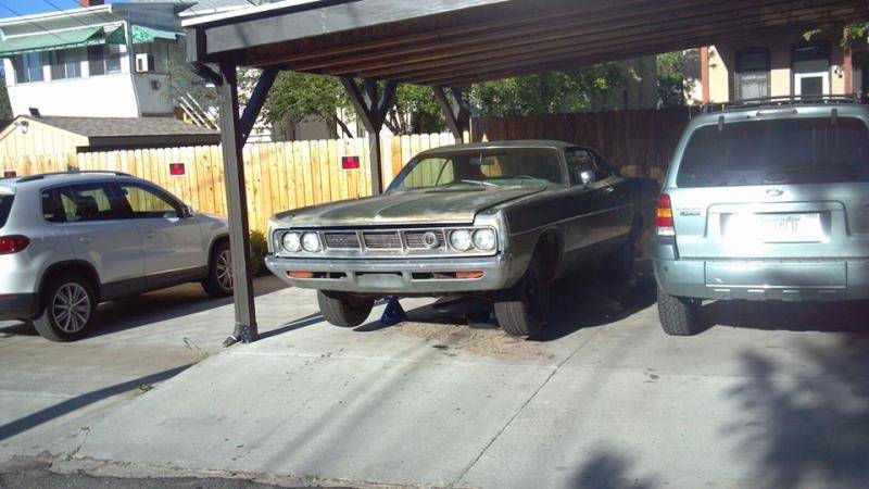

Today I started pulling the front end apart, got the drum plates off but stopped at taking off the brake lines. Everything is in really good shape much to my surprise; the ball joints don't have any play but I'm replacing the uppers anyway. The tie rod ends are definitely gone, the boots are torn straight in half no doubt from being baked in the midwest sun. Bushings don't even look terrible but I'm real curious about the lower control arm ones I can't see them until I remove the arm. Hopefully I'll be getting a hoist and engine stand from a buddy within the next week so I can pull the engine and clean everything up a bit...

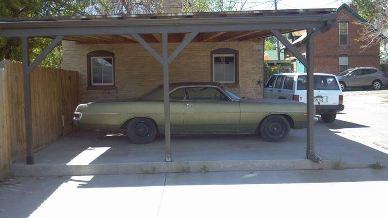

A few more pics and a video of it running...
