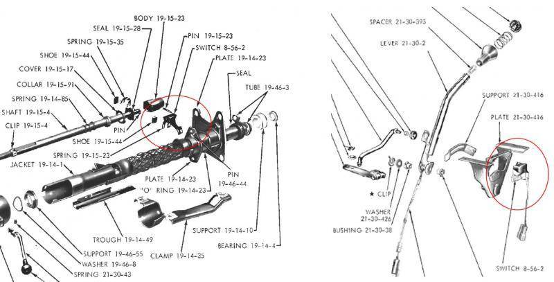

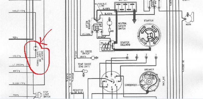

Still no luck with backup lights, I can't track down the switch in attached pic?
Column or console shift?
Console will be on the shifter in the console otherwise at the base of the column.
Alan
