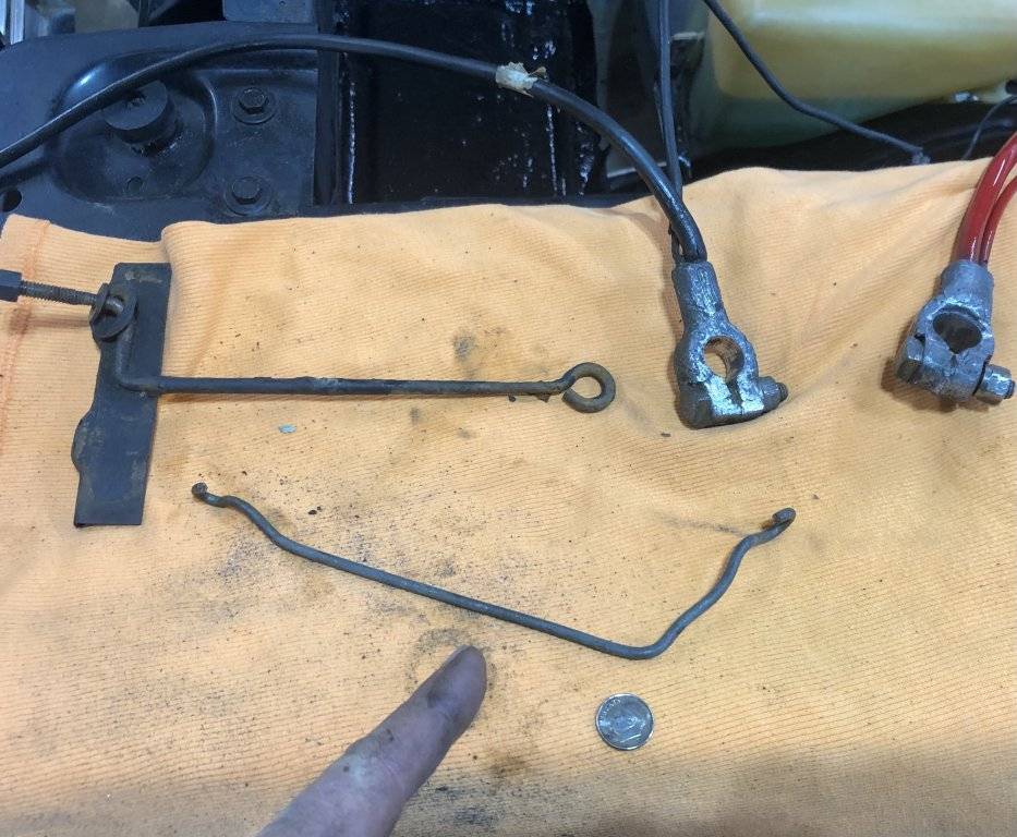

Sorting out the battery hold down. This formed rod was in the battery tray when I got the car. Does it even go on this car? Dime is to show how much money I have left after Christmas.
They may have jerry-rigged it to replace the missing proper j-bolt
BTW the bracket is missing the other web and the one that is there has been modified or flattened.

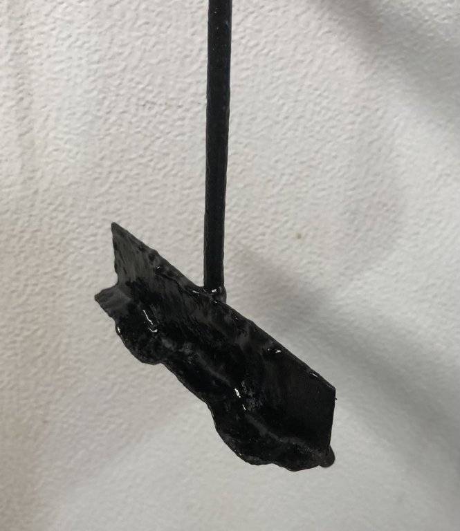

Thank you! . I don’t know why it looks like that in the picture but it isn’t flattened out. I made a web for the missing one, cleaned the coating off and coated it with Flex seal. Not the best repair I know but it’s as functional as the original.

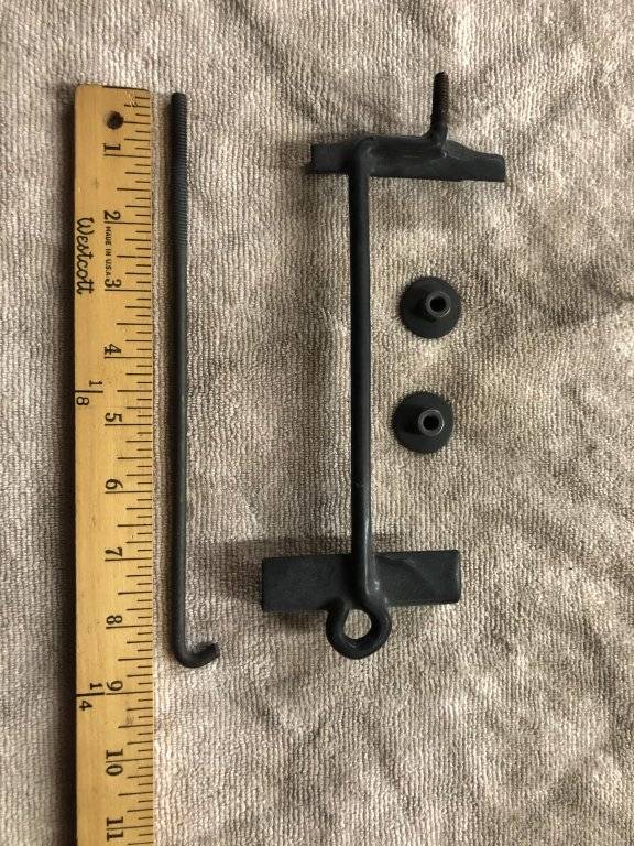

The J hook is missing. Is it .25” rod with 1/4-20 threads on the end?
About 8-3/4
1/4-20 (same as the stud on the bracket)
This is a 69, the offset web was a 69 only, otherwise the same.
