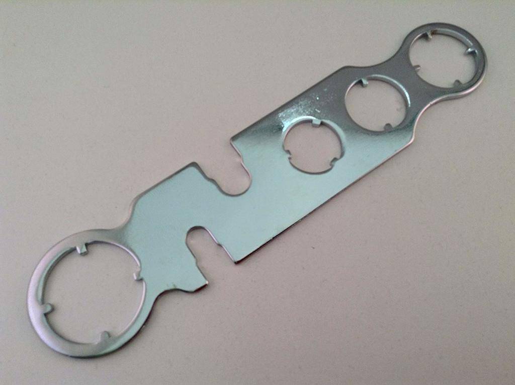

I had to make a special wrench to grip the nut, I used a piece of pipe and cut/filed the teeth in it to grip the nut, I think if was on a B Body. just use some vice grips on the pipe to turn.it. Keep those antenna bases well oiled to keep them from rusting together
