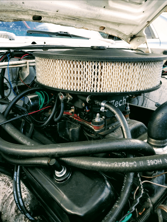

I'm running a K&N filter. We had to beat the base to clear the throttle body. I can't comment on hood clearance because I have a scoop.

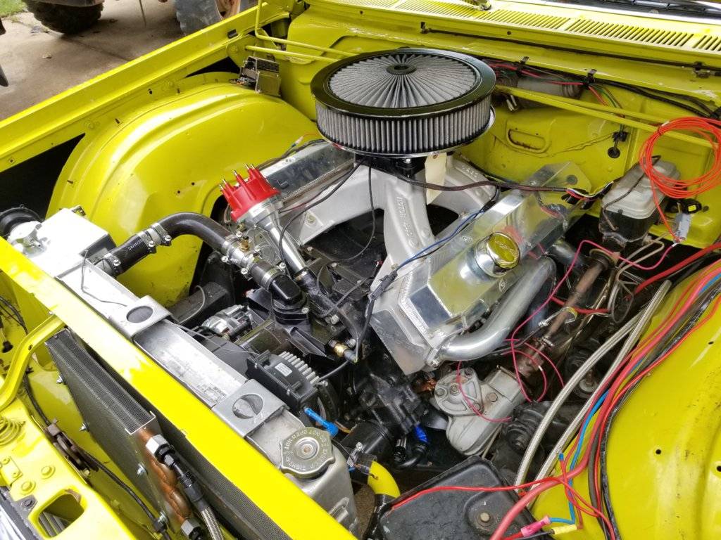

I have some regular 14" aircleaner from amazon. I think it was moroso. I dont have much space between the nut and the hood... Ohyeah, i have a spacer underneath and an edelbrock performer 318/360. Im afraid to post those pics, i wish my engine bay would look like what i see here...

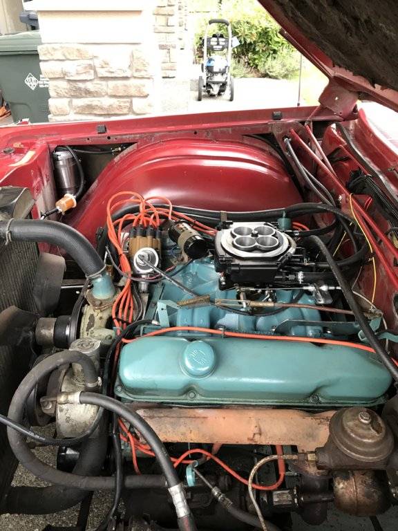

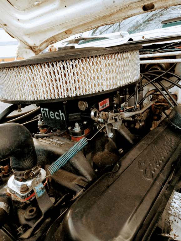

Sniper EFI on my 66 300. I'm using an edlebrock air cleaner right now. FWIW I'm also using a single plane Holley intake manifold that's fairly tall. I'm getting ready to pull my motor and trans over the winter. When I do I'm going to put a decent dual plane on it to lower the throttle body back so I can use the stock air filter housing. The pics below are a bit old. I'm now using a lokar kickdown cable and I've re done all my fuel lines.

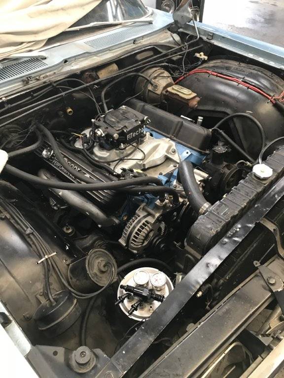

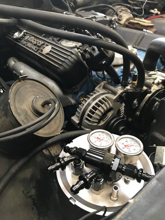

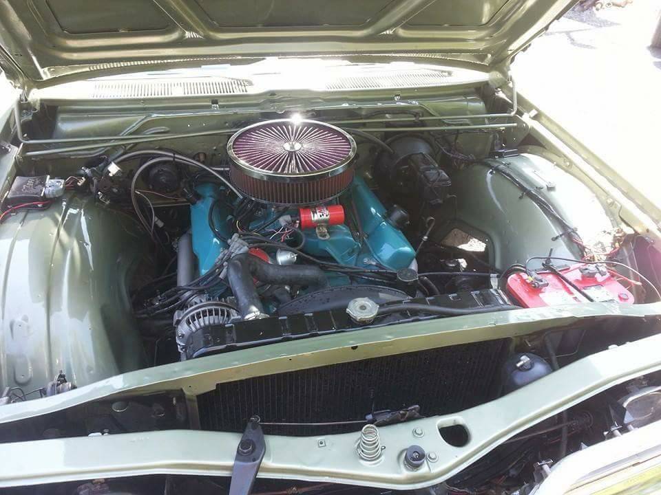

Wish I had more pics of every step, but this is all being done by the mechanic and they are not taking as many progress pics as I’d hoped. But here are a couple that you might like:
