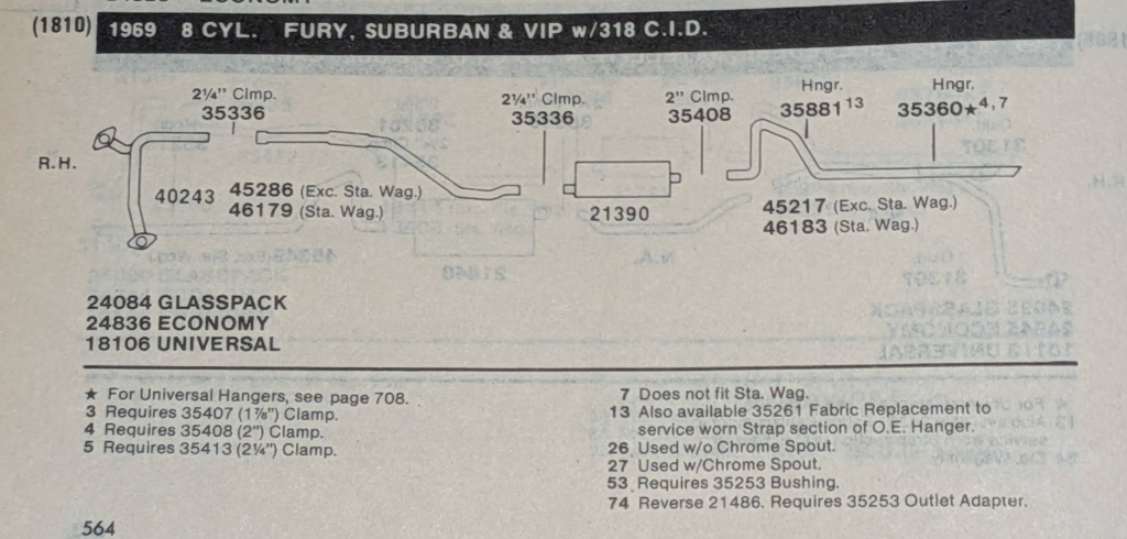

I would love to have the Walker part numbers for the exhaust on my 69 Fury. Seems like the information is not available online. I looked up the OEM numbers and found AP had some numbers if anyone can cross reference:
Y Pipe 2823490 OEM 93119 AP
Ext pipe 2925643 OEM
Muffler 2534431 OEM 839 AP
or 2534441 OEM
Tail Pipe 2781369 OEM
I know Waldren's has the complete system but i really only need the Y pipe and extension pipe.

The listed OEM and AP numbers are for the 318 engine in the 1969 Fury, so the following image shows the Walker diagram and numbers for the same (with alternate muffler numbers and footnotes):
