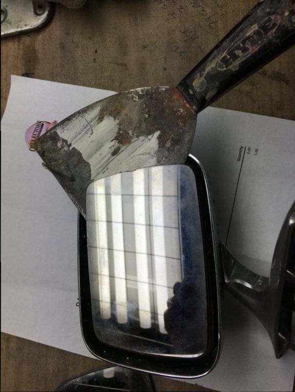

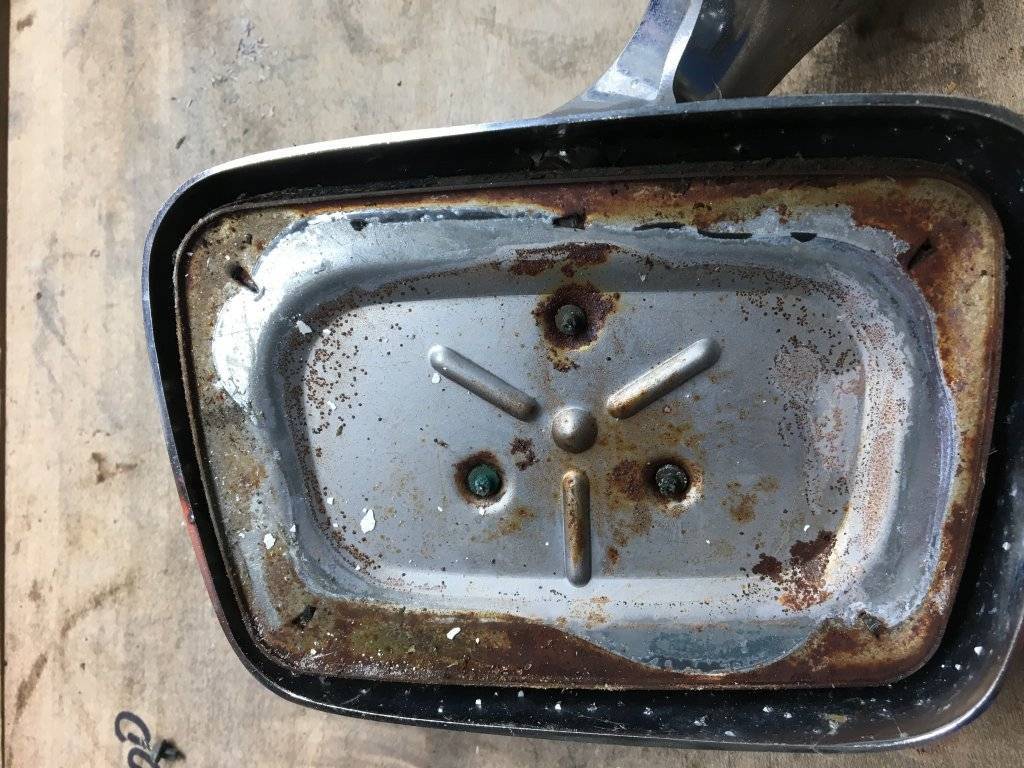

I just did this with my 70 passenger mirror. The mirror was glued on to the mount in 3 places. Trying to pry the mirror off the mount without disolving or heating the glue will break the mirror. I reinstalled mine using good quality velcro in case I ever need to replace the glass again. There was an access hole on the mount and when you rotated the assembly you could line it up with the screw that holds the 2 pieces together. Of course on a 70 the mirrors are round....
It worked. Now I have something to contribute.

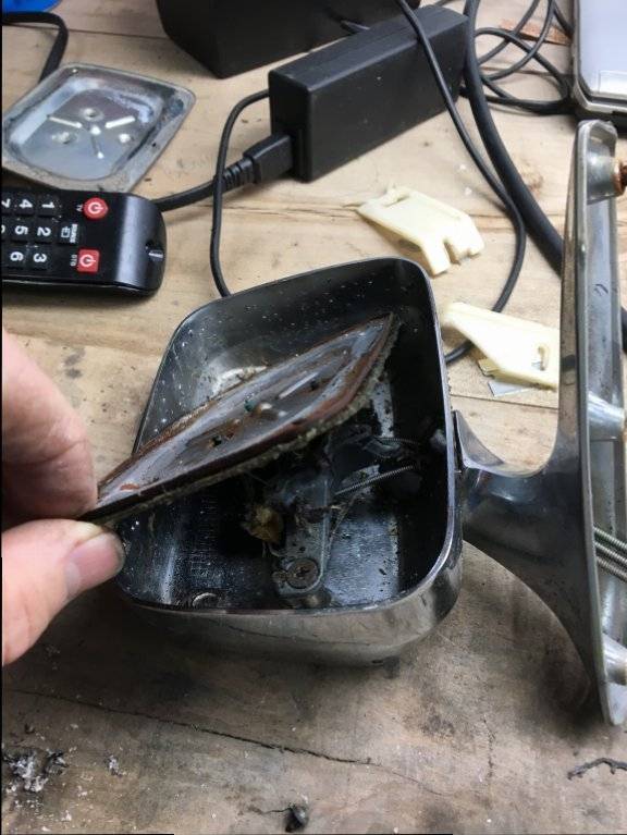

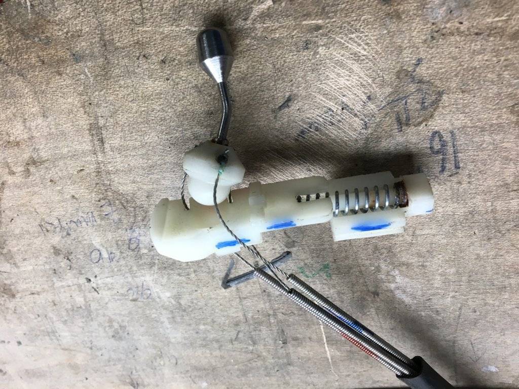

The urethane glue was no match for a Hyde 4" putty knife:

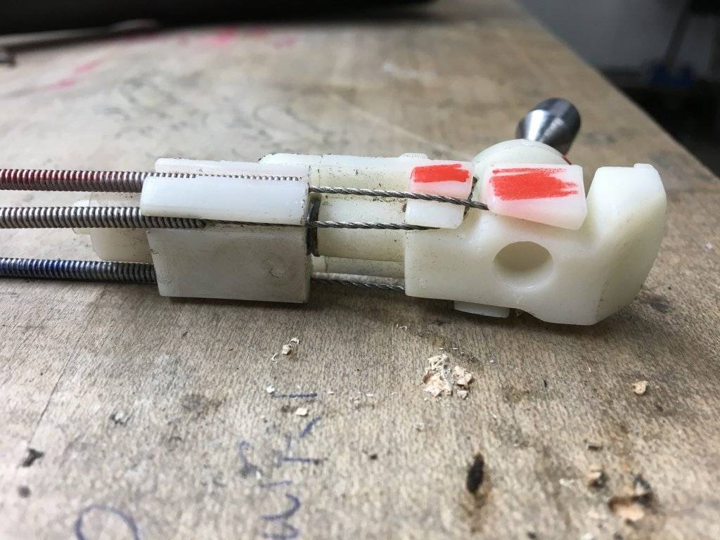

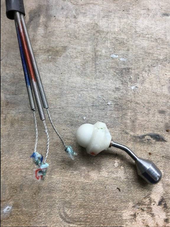

as expected, the mount had the wires from the controller.
By disconnecting the controller,
There was a enough play to disassemble the ball and socket.
With the controller completely removed, the wires could be pulled through the conduit and the whole piece from the mounting plate to the ends of the controller wires could be pulled through the shell.
After reassembly, the tension on the spring on the control holds the mounting plate in position. Just make sure you get the wires run right through the plastic pieces and don't force anything!

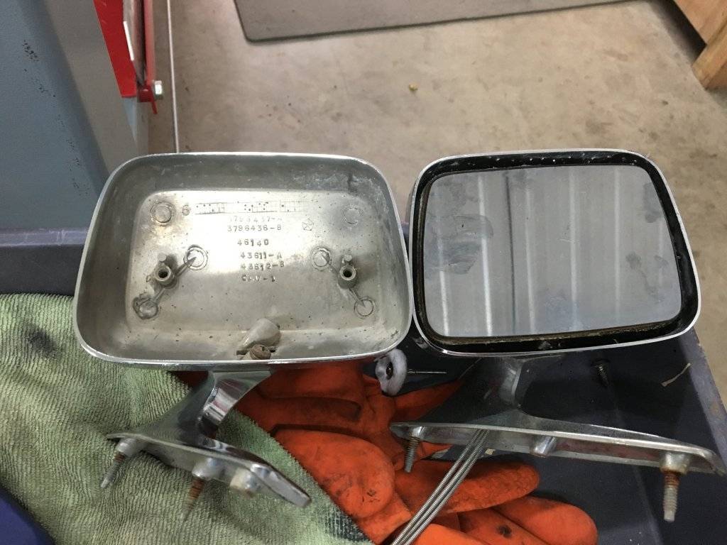

Here is the final assembly pic so you get the wires right.
Wish I'd seen this earlier..I'd have walked you through it. I had to do this on 2 Imperials to rechrome the mirrors. The pedestal is screwed to the head too.
