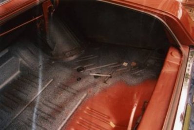

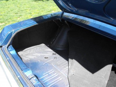

All three had grey jack base, hook and mechanisms.
The two civilian units were painted like the attached pictures, the CHP car was all spatter.

Normally body color and not a very good job/no effort just what gets in there as painting the outside of body true resto should probably be done like that but I always paint trunk fully for preservation and consistency. My 2 cents.

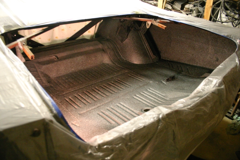

Here is a picture of my CHP 1969 Polara showing the spatter right up to the taillight panel.
Another view
And refinished
The correct color is Duplicolor DM109 Black/Aqua not grey
