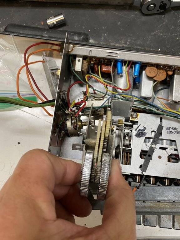

The issue with modern radios are the dials are no longer mechanical, but electrical.
The thumb wheels drive a gear that drives a volume pot and the tuner drives a belt. I have a 68 Polara radio apart in one of my drawers. I will get pictures of the mechanism.

Internal gear drive for volume and tuning.
Plastic gears are stripped on this one.
MAJOR THANKS for THAT PIC! You just spared me the immediate effort of pulling mine and monkeying with it, for now. I just emailed Retro, Their Laguna line would work for my purposes very nicely, IFF I can get the thumb wheel interface for it from them, OR, do as you likely guess I'm thinking of doing with the old stuff from my radio. FWIW, I'll test that one in case it can be salvaged, but I suspect the Bluetooth in 1968 still referred to that state of a wino's dental health.

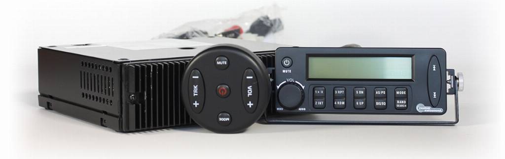

I am considering this. Anyone with some experience with this unit from Tayman?
Secretaudio Radio
With Stealth Sound Technology the SST-V is equipped with Bluetooth for streaming your favorite tunes and hands free use of your cell phone.
The SST-V is a 200 Watt AM/FM radio with USB MP3/WMA Flash Drive, IPod control, CD control and Satellite ready via Bluetooth auxiliary. Featuring "RF" (radio frequency) remote control, ideal for Street Rods and Classics. The SST-V hideaway radio is designed to provide a classic car or truck with exceptional audio quality while leaving the dash and original radio visible in the dash. The SST-V receiver / amplifier unit is usually hidden underneath the driver's seat or behind the dashboard and integrates with the vehicle's speaker system.
Secretaudio Radio

Marine radios meant for a console are compact and have all the modern connections including an amplifier. Here is an example that has a square face but most are round. A lot of other options. So you keep your factory radio for looks and find a place for this somewhere. While compact hey are not small so finding a place for it would be the trick. Looks like most of these would fit in a cup holder. Maybe mount to front seat frame under your legs facing up?
Like me if you already are planning external amplifiers then various "power sports" UTV options exist without the amplification. Here are some examples. they are very small and could fit in a bunch of locations. Including under the dash as an add-on to a gauge package.
Amazon product ASIN B07SLF7P3XAmazon product ASIN B07PLMT446Amazon product ASIN B07BV578YGI may go with this one or similar.
Memphis Audio MXABTRX Bluetooth Controller with AUX | Electronic Express
And here is another version of the secret headless stereo - Amazon product ASIN B09GCTY6KD
