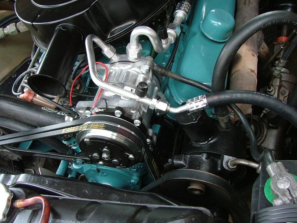

I converted my 66 Monaco 383 using a Sanden compressor with a Bouchillon bracket. Easy job, should be no different with a 440.
That looks outstanding! Did the hoses have to be made?
Also, do you have a model # for the compressor and the brackets? Thanks!

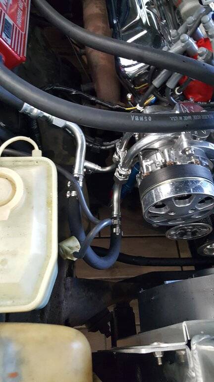

Yes the hoses were all new, I bought a crimping tool and made them myself. The compressor is a genuine Sanden SD7H15 and the mounting kit is Bouchillon #4710.

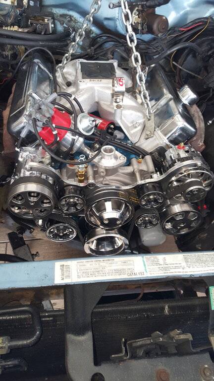

Sanden compressor is part of the serpentine system. I had to make all of the hoses. My engine is a 406. The serpentine system will bolt on to a 400, 440 or a 426.
