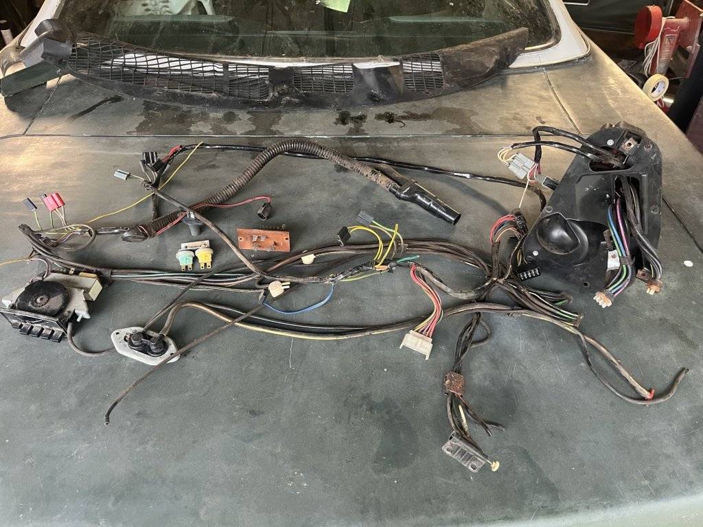

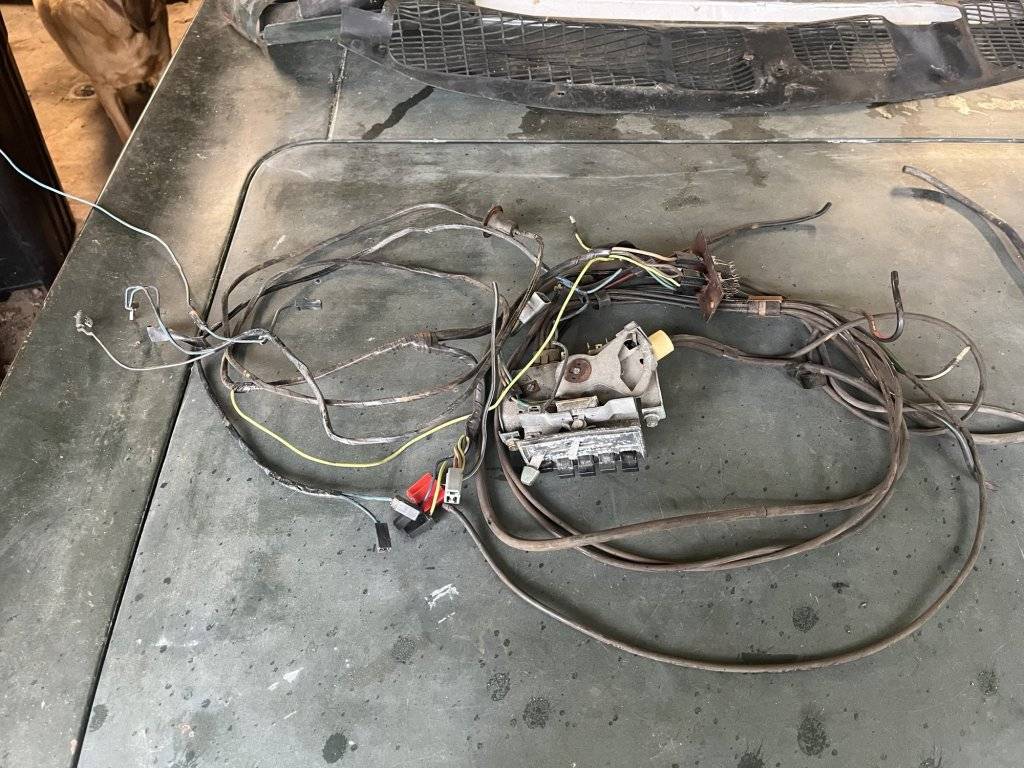

Ok I made some progress. I already have my windshield out and had to remove the dash pad to fix the window channel so I decided what a great time to do all my under dash stuff. I pulled all the manual A/C controls off the parts car (dash control, wiring and vacuum lines) I then compared the HVAC hard parts to my auto temp and all the vacuum pods and doors are the same. I then removed all of the auto temp parts from my car, dash control, control unit assembly (in the pass kick panel), wiring, vacuum lines/check valves, blower motor resistor, ambient air temp sensor, interior air temp sensor, water valve thermostat, recert door vacuum transfer switch, and a couple other sensors that I'm not sure what they are. LOL
It looks like all I need to do is install the dash controls, blower motor resistor (different from the AT) wiring and vacuum lines. I will post pics soon.
All of this....
Will be replaced by this. LOL
