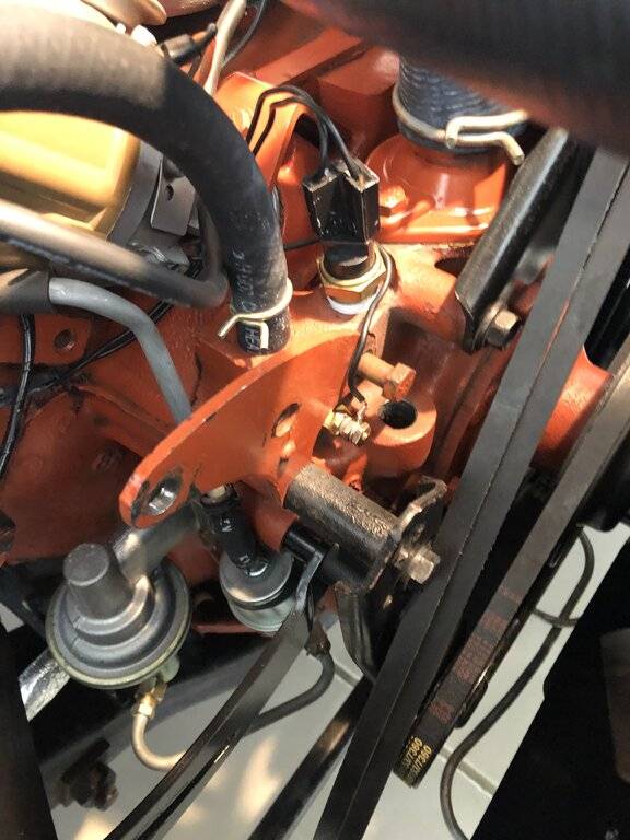

Here's the new fuel line, they look a little different but I think its only because the old one twisted getting it loose from the pump. If there's any issues when I install it I'll post the details, pics... There's no reason anyone should try to make this line when Inline tube has it.

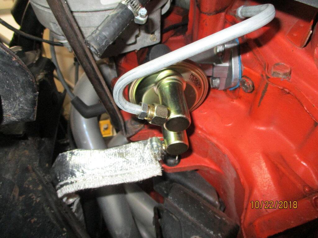

It's a little confusing when you first start to fit it, so here's some pics to show you how that line should be oriented. You don't want to tighten the flare nut until you have everything in place, right up to the carb. It takes some wiggling to get it right.
