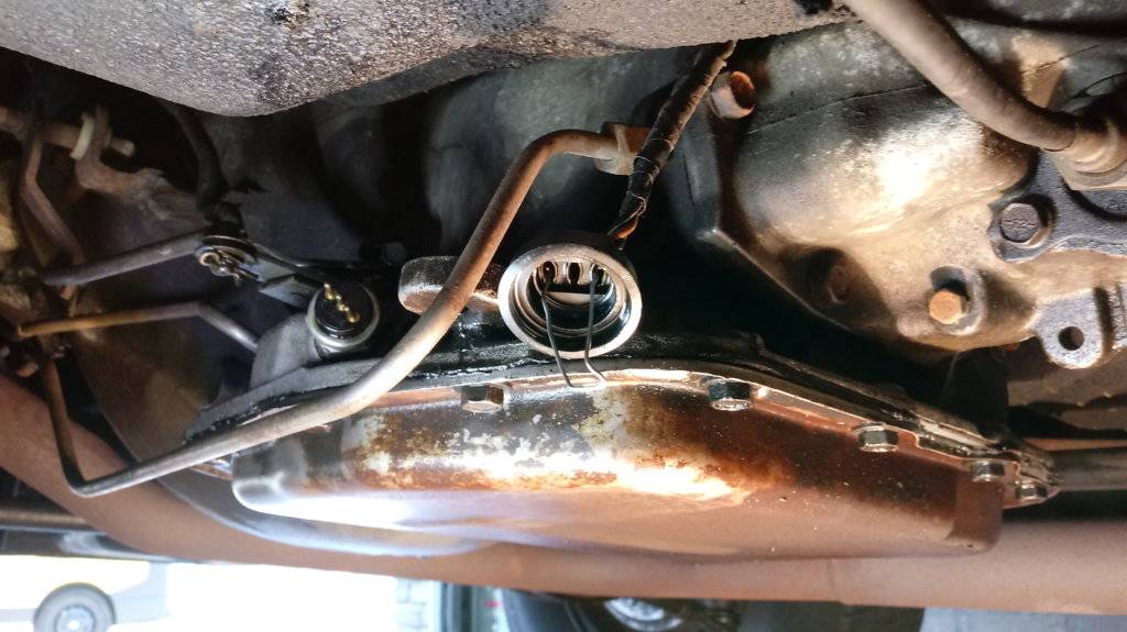

I know, true this forum, that the 2 outer pins of the switch are for the backuplights. So I thought, when I bypass them the lights should work. So connected the plug like this:
thinking this is how the switch works when putting trans in reverse (and ignition ON )
Lights NOT working :(
Is my testing OK or am I doing something wrong ?

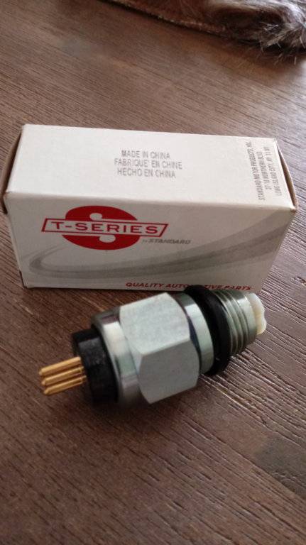

All tested as discribed above. Must be the switch ánd that came in the mail today. Ordered at RA, made in China...
Now the next question: can I expect a lot of ATF pooring out when unscrewing the switch ?

Today I made an attempt to replace the NSS. Jacked the car up, crawled under it but could not get the damn thing out. Not the right (deep) socket, not enough room to make it turn, so after some time I said to myself: F... it, I'll do it an other time, now I'm gonna take a ride. And now, surprise ! As if "someone" told me: check the backup lights once more, the lights were working !! Problem solved. Now at least I have a spare..:thumbsup:
