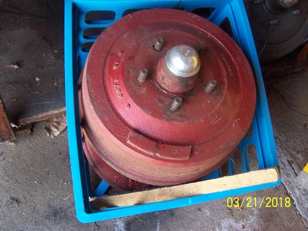

Here is a pic of the drums that were on my 68 Charger when I swapped them out for discs. Pretty good sized weight on one of them.
