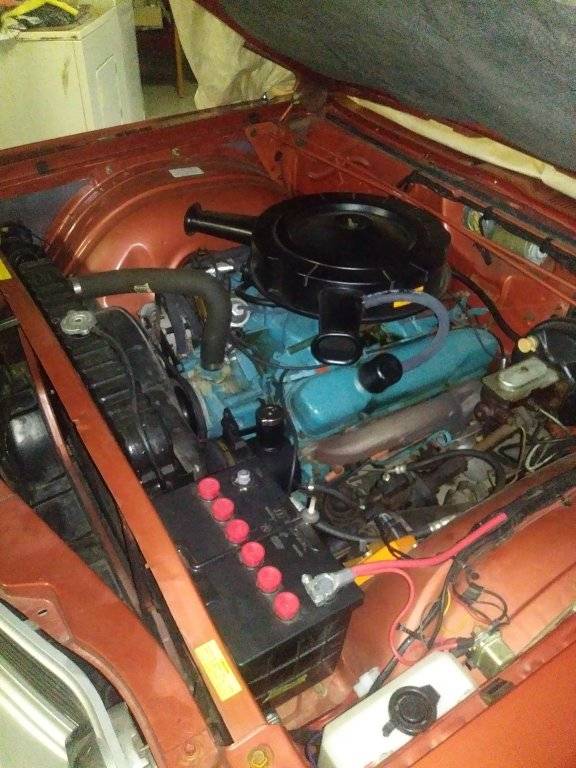

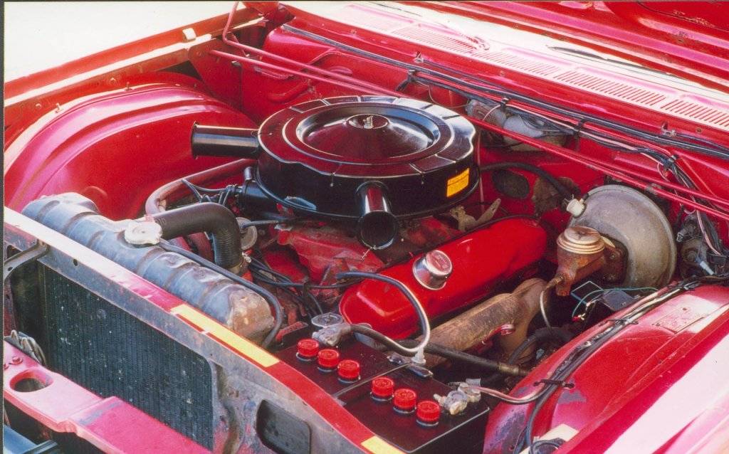

Group 27, red cap, non tar top.
Seems like Group 24 was standard (non-a/c) and Group 27 was optional as the upgrade w/factory a/c. Above graphic is accurate. Cap color could change, though? Our '66 Newport 383 2bbl factory a/c had a Group 27 from the factory. Always liked that it was the biggest available for those cars.
