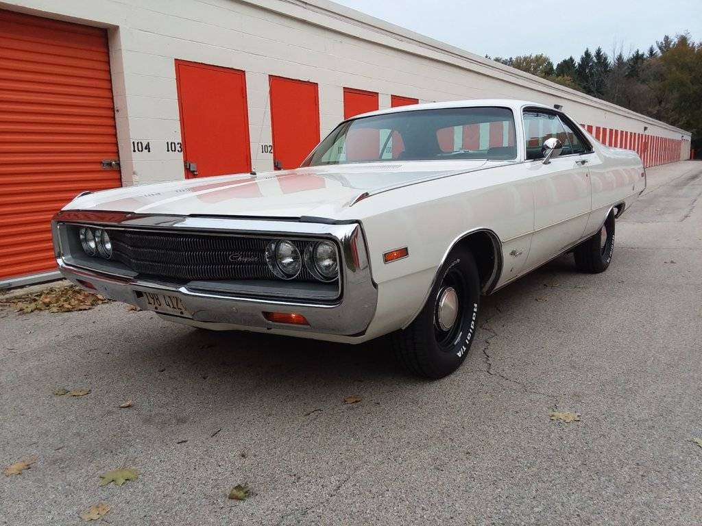

Does anyone have suggestions how I can straighten the trim pictured here?
(Above passenger side headlight)
