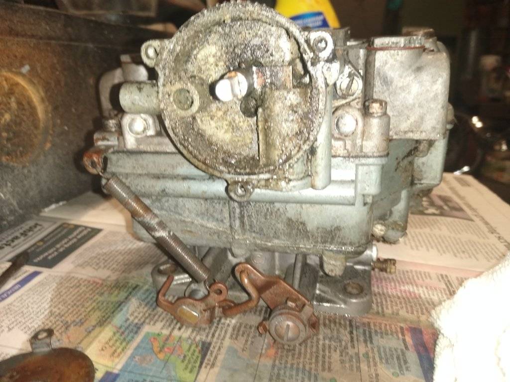

Being old school, I've always used lacquer thinner. What's the strongest cleaner/chemical that will clean my carb that looks to have been partially submerged in water for quite some time and was frozen.
I sprayed WD40 over it many times and was able to get parts moving, but now I'd like to take it apart and let her soak. I heard a method of cleaning dirty guns was to boil them in water? What's better than lacquer thinner? Paint remover? Not sure about the commercial brands like Berryman, etc.

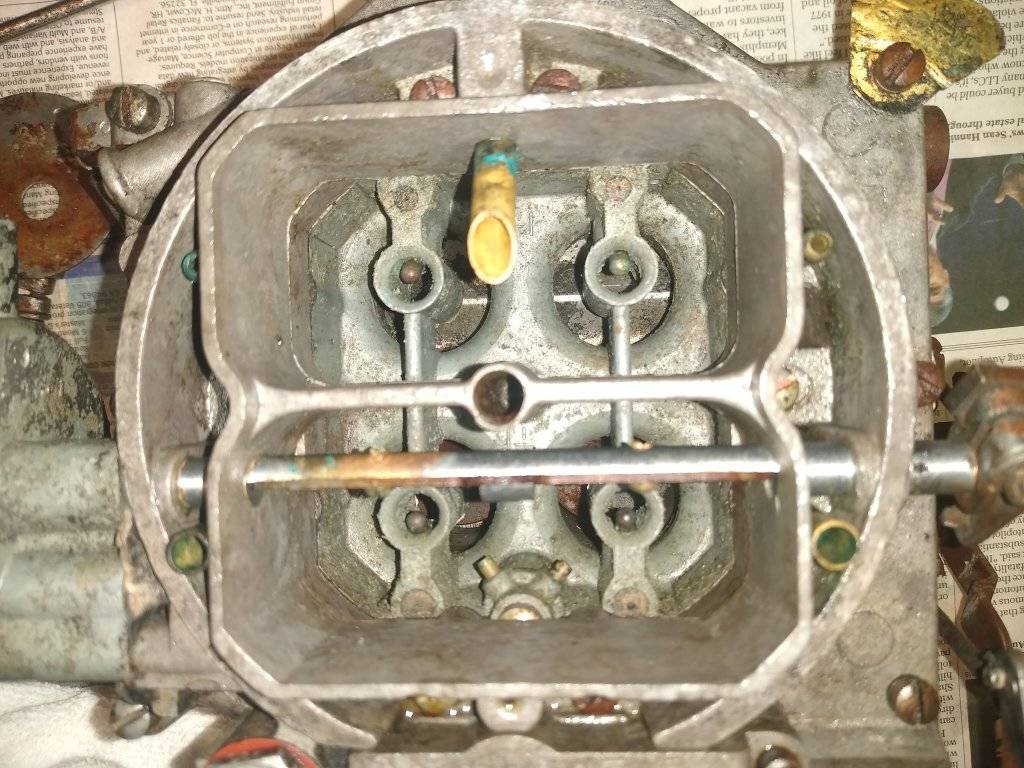

Any of those cleaners will certainly clean the varnish and such, but NOT touch the hard deposits in the venturi cluster passages and drilled calibration holes, which many found out in the middle 1980s when there was one brand of gas which became famous for such deposits (that brand also vanished after that). Those things will need to be removed mechanically. In the one carburetor I fixed like that, it bought a selection of very small twist drills and cleaned the brass idle tubes until I "got brass" in each one.
The OTHER thing you'll need to do is re-seal the gall bearing and solder "plugs" in the main body, if there might be any. Ethanol'd gas will eventually eat the solder, which will then let the staked-in ball bearing seal fall out and cause problems with gas on a hot engine. So look for that sort of thing on your vintage carburetor, too.

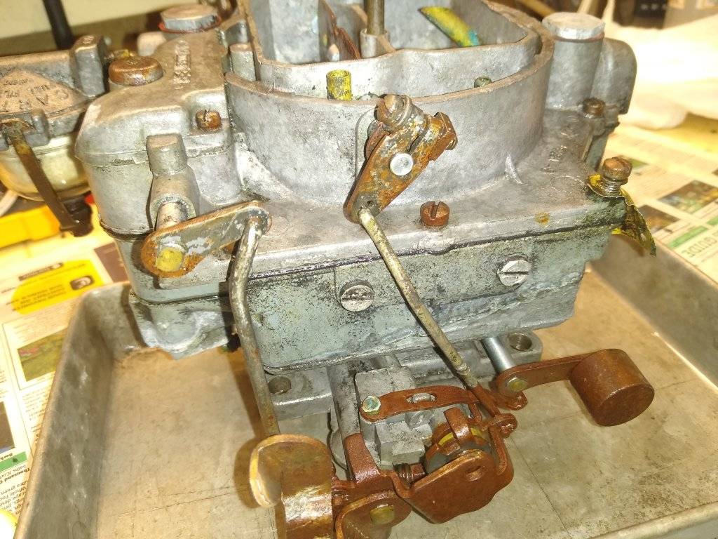

Thank you all, I just had a thought. Since it appears that the carb was in a drain pan stored somewhere where there was exposure to rain water where the pan filled and partially submerged the carb to water over a period of perhaps years. What do we use to remove water deposits? CLR!!(calcium, lime and rust remover) I'm going to try some tomorrow as I KNOW it works to dissolve scaling caused by water.

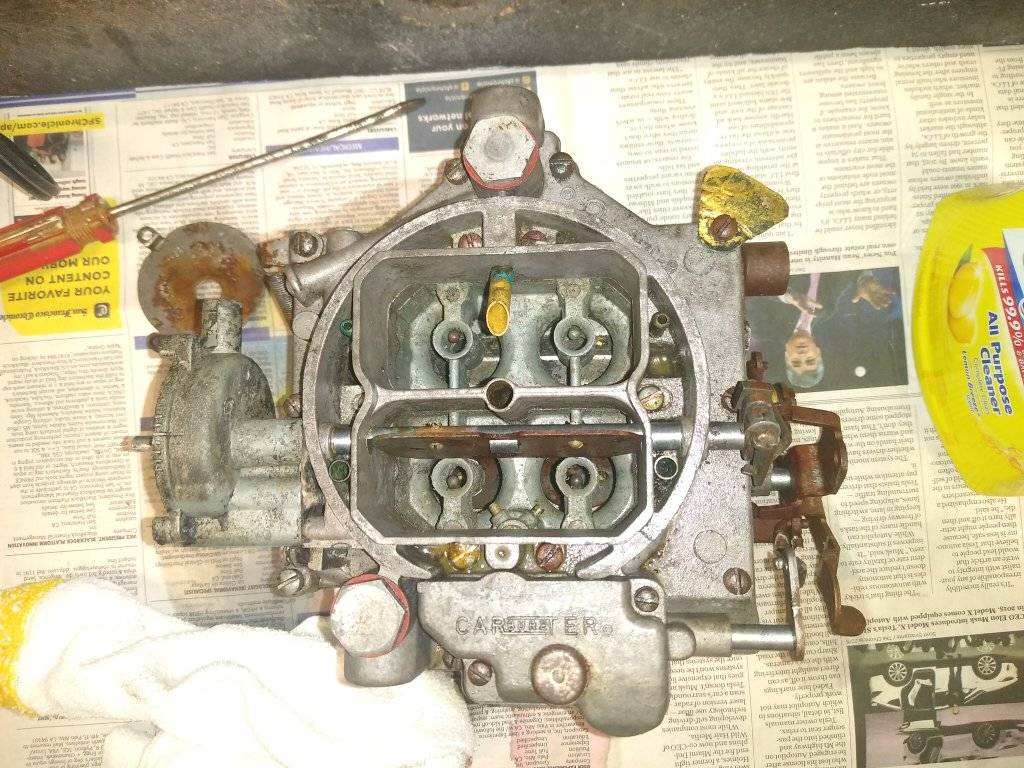

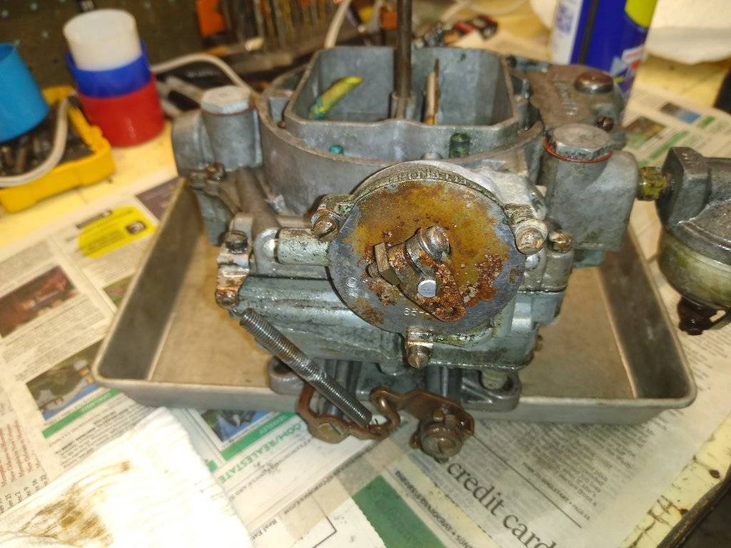

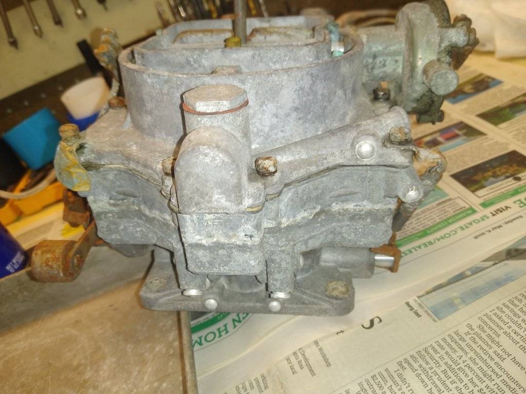

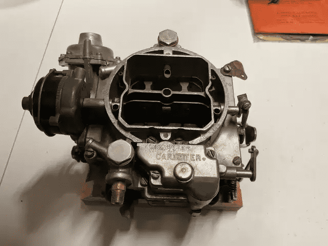

I cannot imagine that carburetor can be brought back to life. The deposits you are talking about would be aluminum corrosion from the water submersion. Do you have photos of the carb?

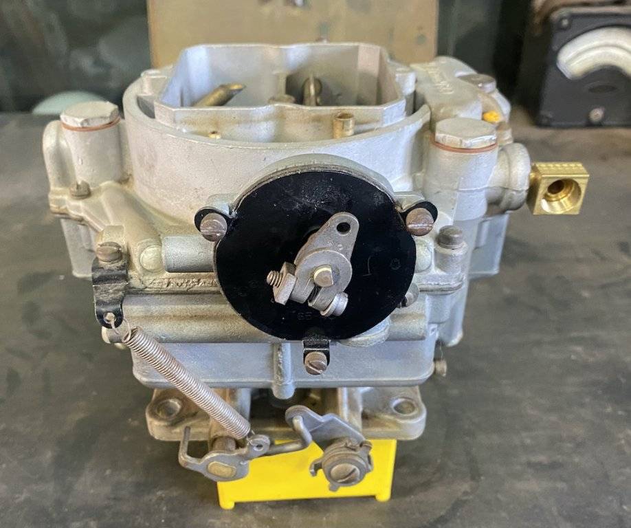

Apparently, one with this choke setup is hard to find. The Carburetor Center thought they had one and sent me one with the wrong choke. They have no others. Mine has an arm that attaches to a thermo coil in a well beside the carb
IMHO, anything strong enough to clean that carb up is going to affect the material the carb is made from adversely.
That said, a lot of guys have been using Pine-Sol in a ultrasonic cleaner. Even that will damage aluminum if left it too long.
Probably the best way to clean it is to lightly glass bead blast it.
Those methods require equipment that most don't have access to, so the most cost effective way to clean it is buy another one or have a pro like @Dana at Woodruff Carbs see if he can work his magic on it.

Now . . . as many have seen on the Saturday morning cable TV car shows, ANYTHING is possible with enough time, money, and expertise. As in rebuilding a motor, knock-out all of the plugs, soak the carb in "the solution of choice" to remove the aluminum corrosion, then "rod out" the passages and clean them to their original diameters, mechanically cleaning them JUST to get to a fresh surface, so the same things on the venturi cluster, then chemically wash everything to kill any acidic fluids which might still be in the castings, re-seal the drilled passages as needed. Ensure the orifices and passages in the venturi cluster are open and clean (including the "low speed jet" toward the bottom of the brass idle tubes!).
That automatic choke assy looks somewhat common for the middle 1950s or so timeframe. It could well have an internal piston/rod which serves as an internal "choke pull off" mechanism, which can be difficult to make work right (at this point in time, needing particular attention to the bore the piston and rod operate in (looks just like a miniature engine piston!).
