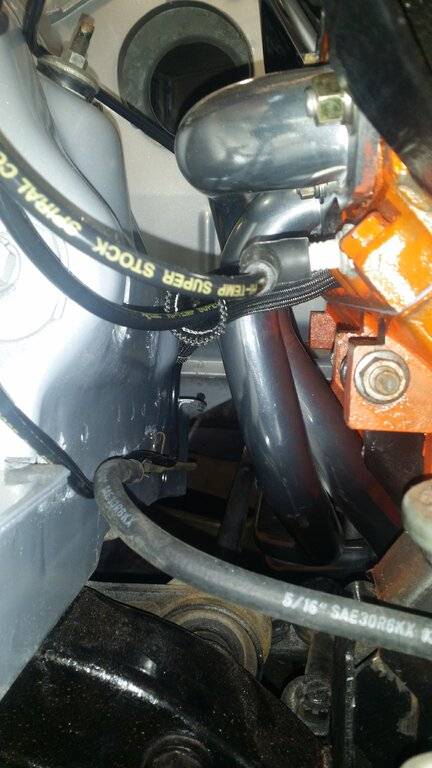

TTI are VERY good BUT on the higher price side, we got a set on our 67 Fury II 2-door sedan. They fit pretty good overall BUT we did have 1 issue with the fit, we had to make a dent in it.

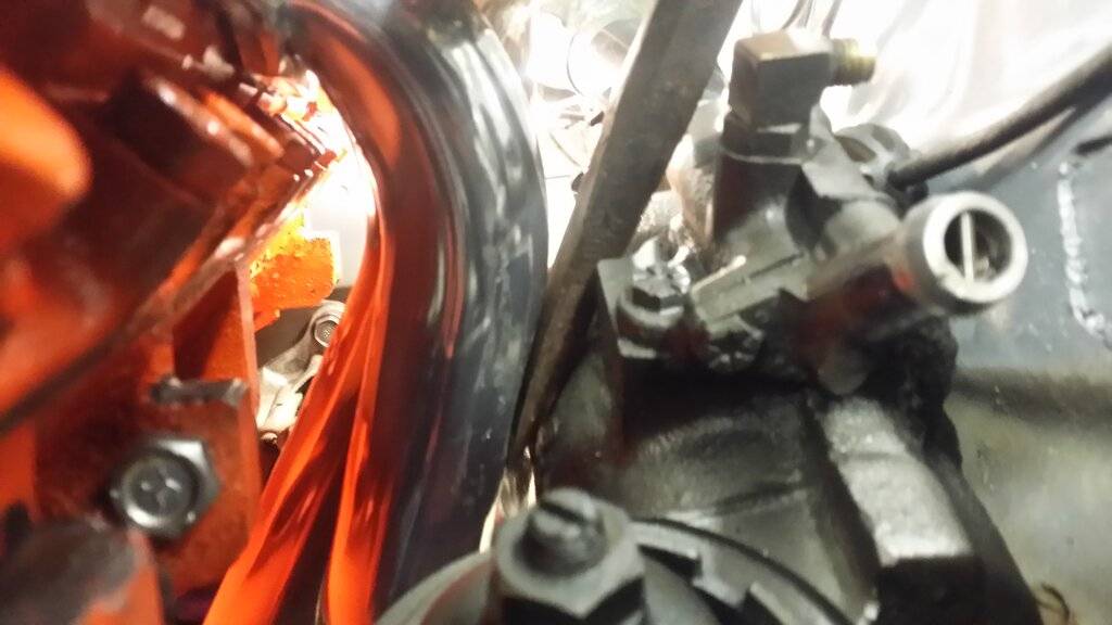

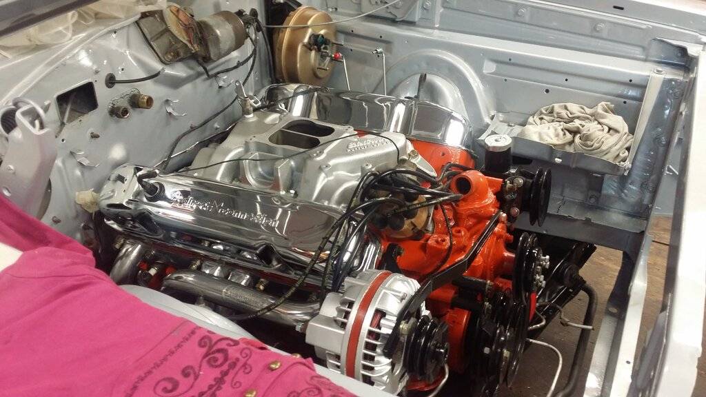

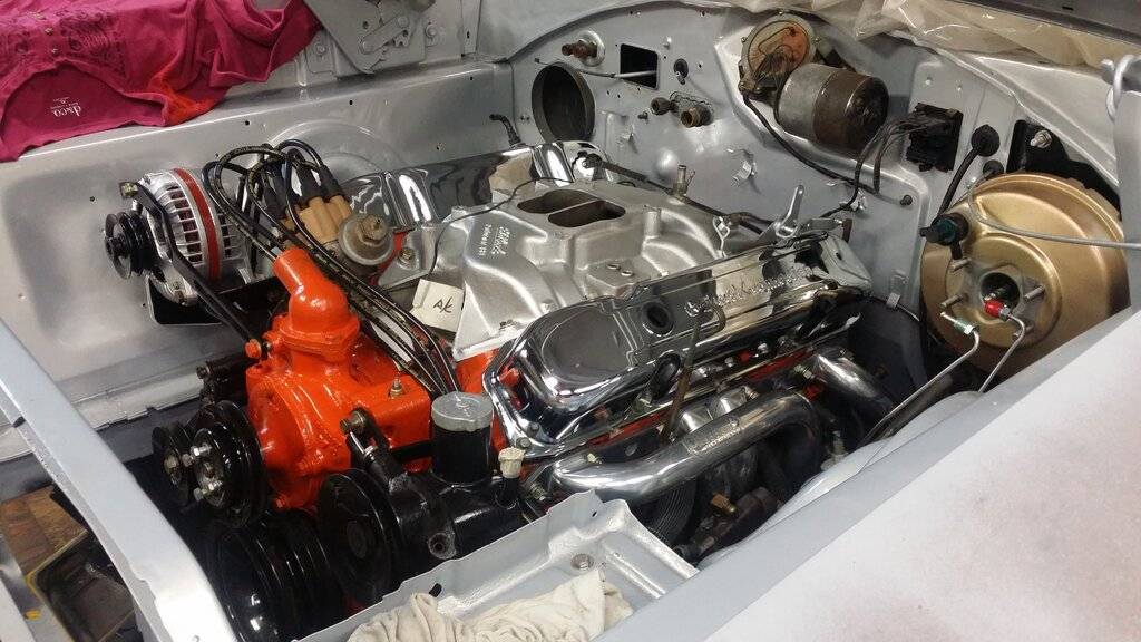

Now we have Hedman Headers on our '66 Charger project, this is the first time we used these and they seem to be good headers. We did however have issues with these as well with fitment, we had to clear the steering box to clear the transmission pan

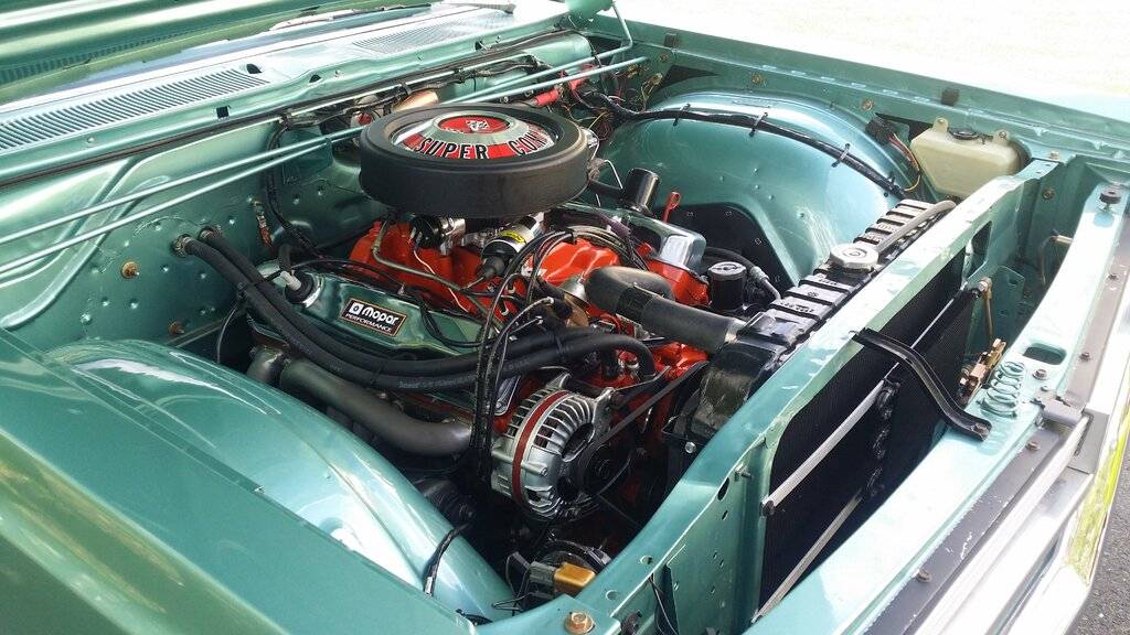

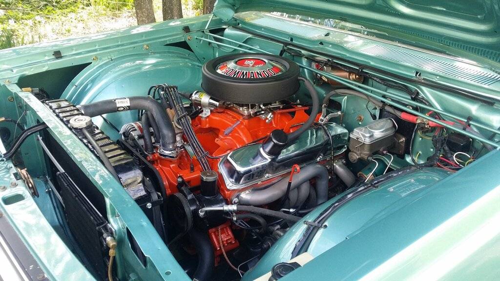

We also have Hooker headers on our 67 Fury III 4-door Sedan and they fit fantastic with no problems.
