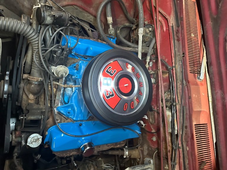

Hello folks, I am considering upgrading my 67 Newport Custom to a 4-barrel setup. I am not trying to make some kind of hot rod out of the car. The existing Stromberg WWC 2bbl needs to go, so I am thinking of upgrading to 4 barrels. who sells a reasonably-priced manifold and 4bbl for the 383?
Alternately, I would keep the 2bbl manifold and just replace the carburetor, if there were a bolt-on replacement. The guy at Daytona Carburetor tells me the bolt pattern for the WWC doesn't match the other carbs that were used. Is that right?
Any advice will be appreciated.

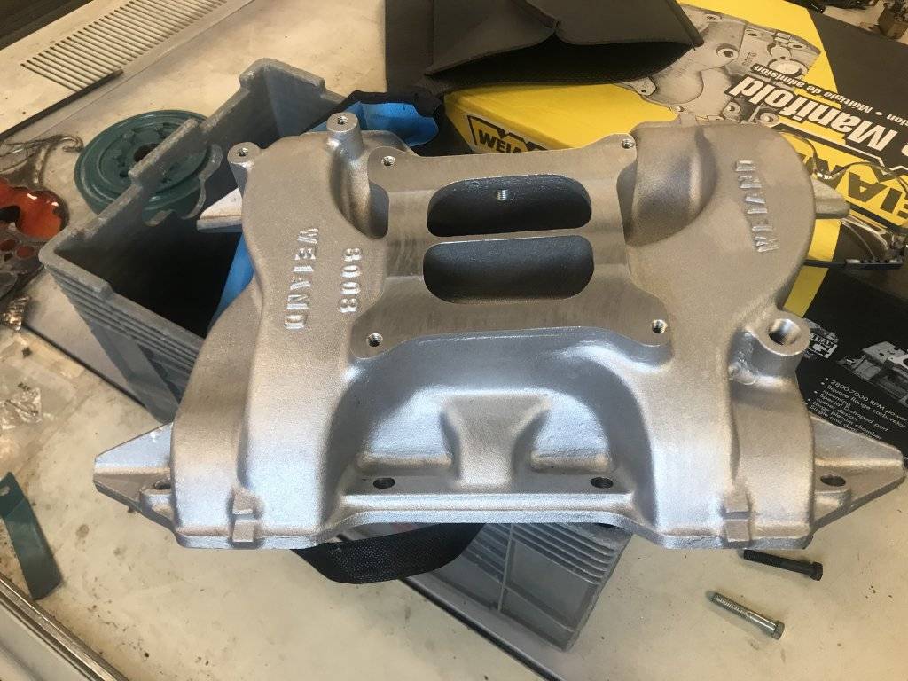

If you do go with a 4 bbl swap. My favourite is a spread bore intake from a 400 4 bbl and a thermoquad. If not factory iron, you can find a good 383 performer Edelbrock intake with dual bolt patterns to fit square and spread bore carbs.
I switched my 72 Newport 400-2 to an Edelbrock performer and a Holley spread bore 4 bbl. Both picked up used very reasonable. That being said since then I have acquired an Edelbrock dp4b and a performer rpm (both used) for later should I ever get back to the project.

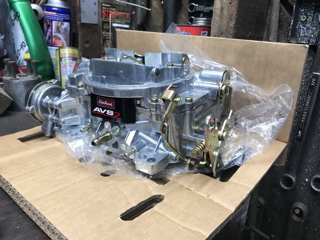

These are what we have been using and are happy….
The larger base plate hole started in 1968. "Holley-sized" rather than the smaller, prior AFB-sized. AVS is the large size, too.
Luckily, the ONLY thing that will need to be changed is the air cleaner base, as the filter size did not change.

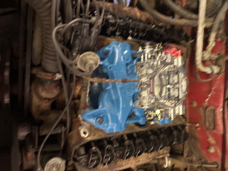

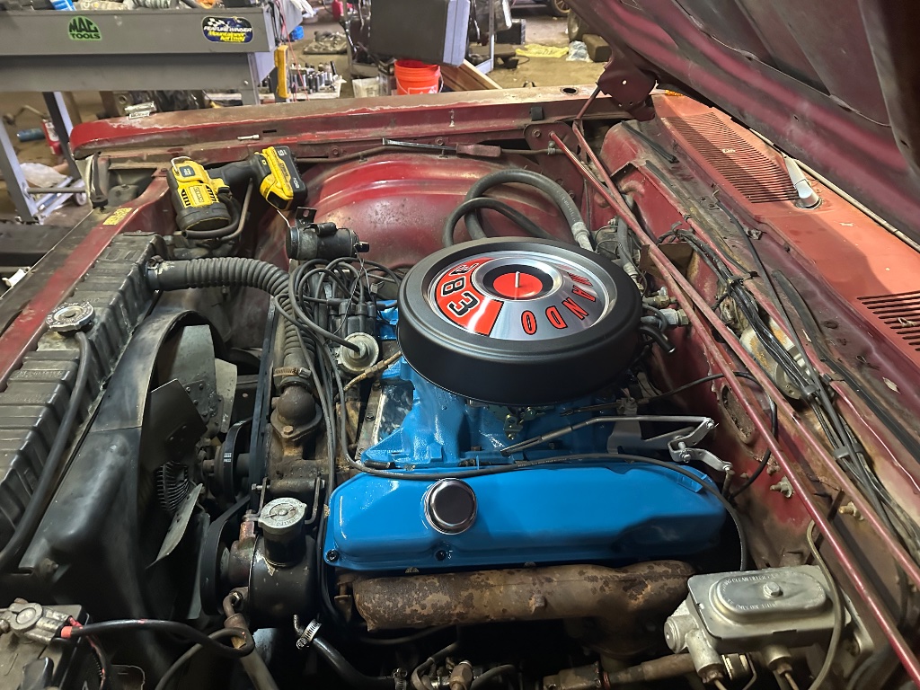

I use a stock intake from a 70 charger 383 if I remember right and a 1406 Edelbrock on my 67 Fury 383. I have the Mopar performance air cleaner. Because the stock one sucks and it want fit a four barrel carb anyway.
