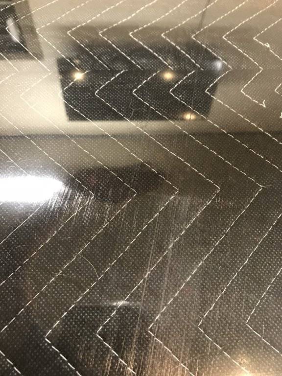

I have seen that scratches can be polished out of the tempered glass side windows. But not sure what to use and the process required. Some say to use buffing compound others say they have the magic formula.
What have people here used to get out glass scratches?
Years of going up and down with dirty wipers.

My go to product for glass, stainless, plastic, paint etc is Rottenstone (about $12/lb on Amazon). Mix it with water, light oil etc depending upon what you are polishing. I've always used elbow grease but one of those fancy buffers would work as long as its not pushed too hard. Heat is your enemy when polishing glass, plastic and paint.

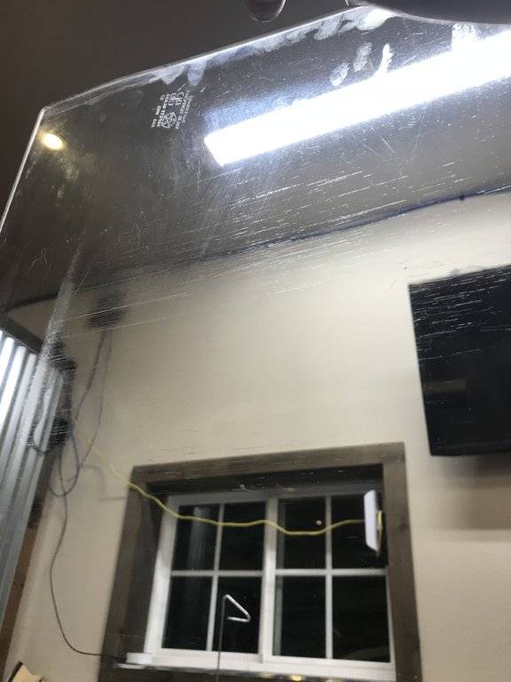

I tried the pumice/ rubbing compound method, but believe my scratches are too many and too deep. I ended up ordering some sanding disks. I think I will have to start with them.
I don’t have much to loose. I have a drill adapter, but would rather fine a 3” wheel for my buffer to help keep the disks flat. Keep a spray bottle handy to keep it cool.

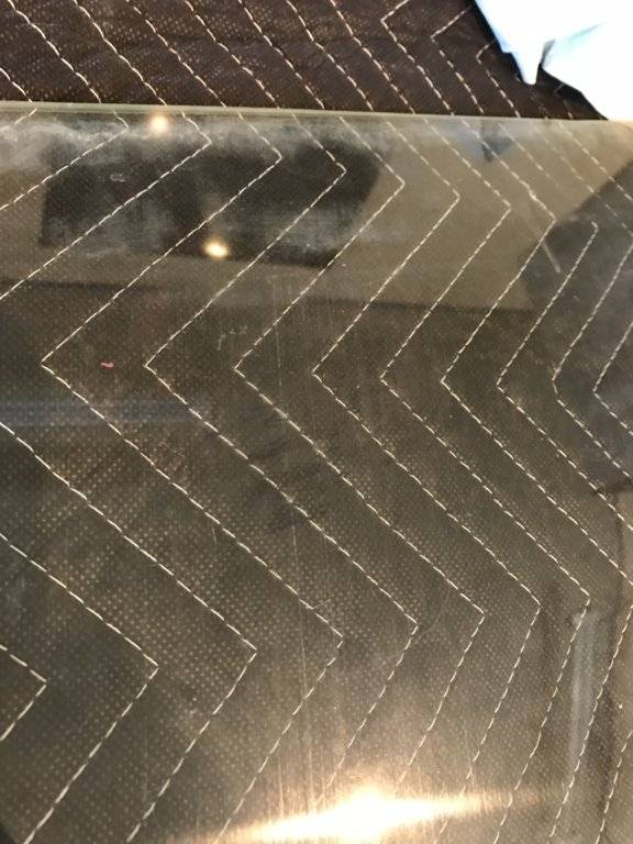

I don't think you are going to get those scratches out. They look too deep in this pic. There's a point at which you start distorting the glass and it starts looking "wavy" as you look through it.

Can you catch your nail on any of the scratches?
There are 2 spots that I can catch my finger nail. Both are within a couple of inches of the bottom felt. So may have a chance. I am going to experiment. If I mess it up I am only out time.

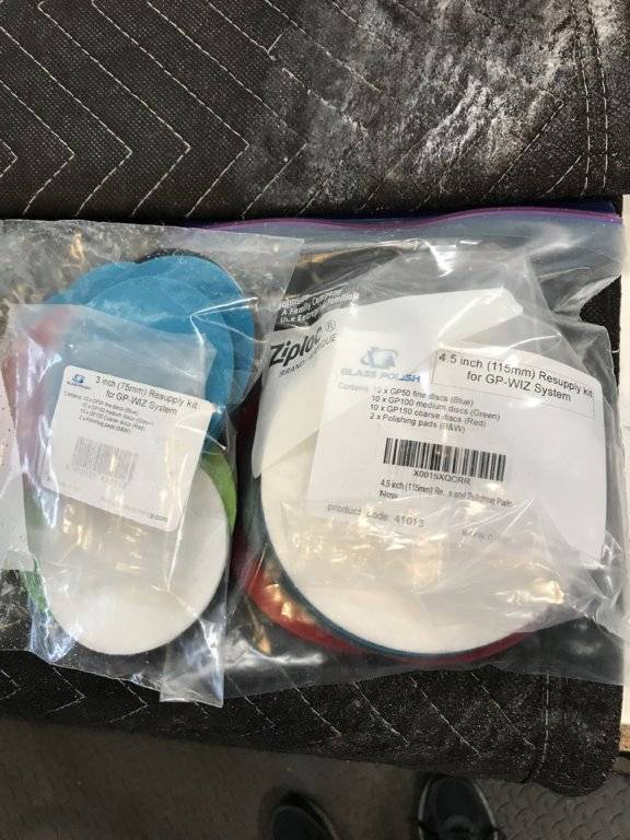

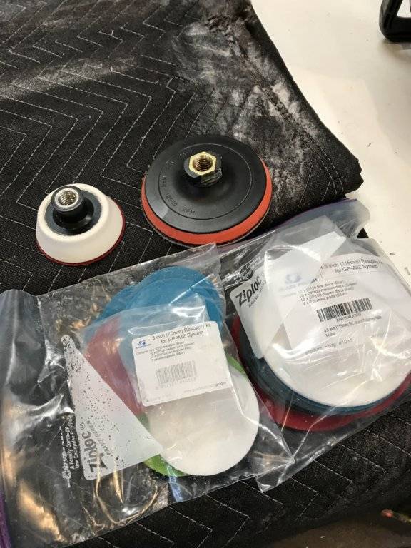

The scratches were pretty aggressive. No amount of polishing would do anything. Not one to give up I went online and found these.
And these for my buffer.
Yep it is sandpaper

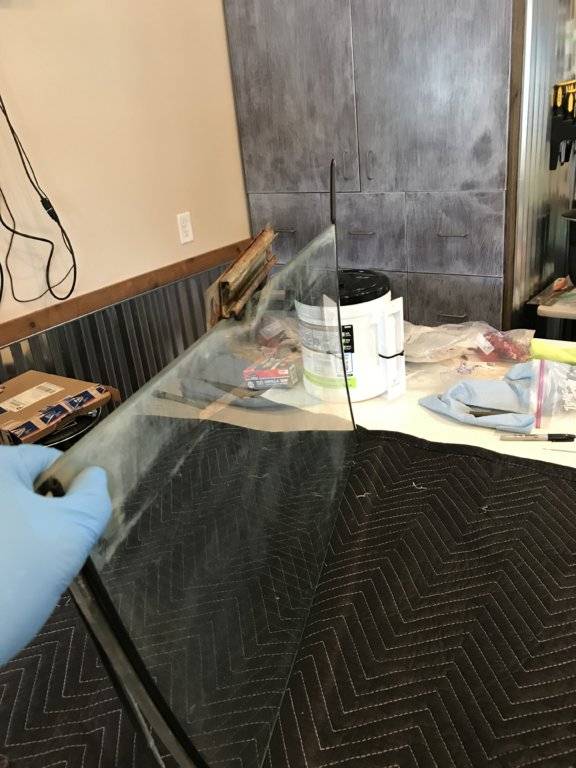

Started with the 3”, but was too small and easily left more scratches. So went up to 4-1/2”. A little more finesse required due to the curved glass.
Two weeks later and doing it twice I got the vertical scratches out, but introduced some small circular ones that I cannot seem to get out. This wasn’t fun at all.
Over all it is better. It is not as clear as new. So I introduced some distortion, but is about like looking through safety glasses. It will be drivable and keep the weather out until I find a really good used one or stumble upon a NOS piece. My other windows are scratched but not as bad. I think polishing only.
