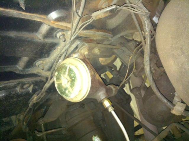

Do i have to bleed my master after having the reservoir run dry. I damaged a brake line while working on the car and by the time I realized the puddle on the ground the reservoir was empty. Can i simply add fluid to the system and bleed the brakes or do I have to bleed the reservoir first. It is a manual brake system and I have included a pic of the master for reference.
You should be good with just bleeding at the wheel cylinders. The MC should be fine, just keep it full while bleeding. The only car I have ever had to bench bleed a master or slave on was an MG.
