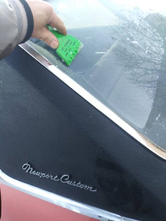

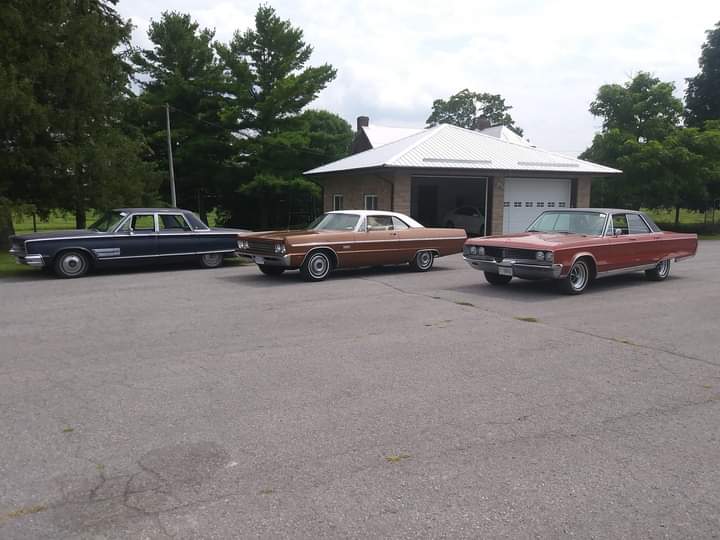

I have blocked the crossover on a few big blocks.
No issues.
The difference is I run Edelbrock carbs with an electric choke.
My car is out up to late November even if there is frost on the windshield.
The electric choke works as it should as it is not affected by the blocked crossover.
In the hot summer months, the temperatures at the carb dropped by half and no boiling of the fuel in the float bowls and no need to run an electric fuel pump.
I do run heat sheathing on the fuel lines.
Another 20 to 50 degrees savings.
With a cooler denser fuel, I am able to run a bit more timing without any ping.
Hot or cold, no long crank times either.
Hope this helps.
