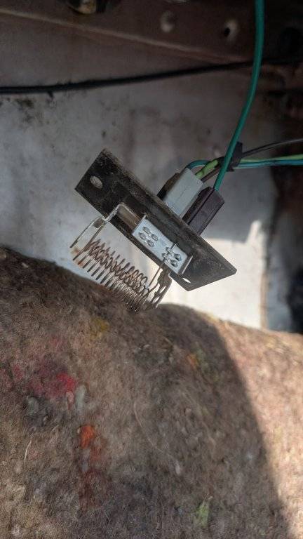

So far I've removed the lower dash panel and traced wires from the switch to the resistor, everything seems okay and I removed and inspected the resistor and it almost looks new.

Picture of the resistor for fun.
Does the blower motor poke out into the engine bay, and is there a wire running to it? If so, that's the feed from the blower motor resistor. The motor grounds to the chassis, so if you put 12 volts directly to the wire (there should be a connector), then the motor should fire up if it's good.

Pretty sure the green single wire on the blower resistor is what feeds the blower motor. Look at the wiring diagram to be sure.

Is this is the likely candidate wire? (Pictured red arrow) Seems to be the one, as it branches off from the rest of the harness. I will double check my wiring diagrams though, I have the chassis and the body manual hopefully it's in there somewhere.
So (assuming that's it) I could I just unplug that from the resistor and attach it to a 12-volt power source and bump test it?
