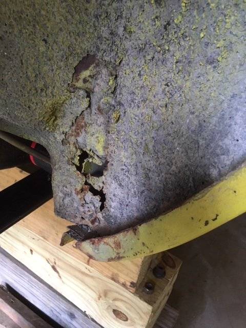

I bonded two pieces of scrap metal together that’s the same thickness as the thickest piece I need to repair. I used the E6000 stuff. It says it needs 24 hours. I’m going to give it 72. See then if I can pull it apart. If I can’t then I’ll submerge in in water over night & try again to break it apart. I’ll let you know how the highly sophisticated test go’s. Also here is one area I’m wanting to patch.
That looks like a non structural area. You're going to have to blast/clean it anyway to use that panel bonding glue so I'd just mix up some Marglas filler (fibreglass strand reinforced bondo) to plug the hole, sculpt it up pretty and call it a day.
Kevin
