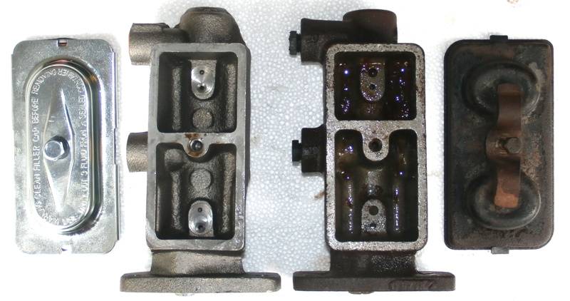

I don't know if this valve gizmo is in our (drum) MC's, or if it's the cause of the various issues that crop up in these brake threads, - so for your viewing pleasure:
On disc brake cars the little valves in the master prevent the rubber dirt seals on calipers from pulling the caliper pistons to far away from the brake pads.
The rubber dirt seals are what pull the pad away from the disc when the pedal is released so as not to have excess pad dragging.
Without the restrictor valves the pad would be pulled back way to far and the take up time when the pedal is pushed would be excessive.

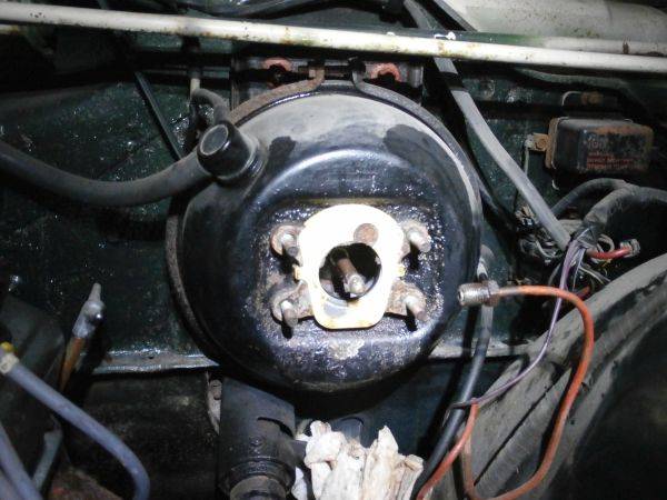

I have a question for you guys, I have a '66 Town & Country and it's having brake issues.
The car has front and rear drums,There was a problem before I started working on the cars braking system, but it seems to get worse then it was.
The car had issues that the brake pedal would lose pressure after braking a few times, after a brake inspection I found quite a lot of things wrong on them.
The shoes where cracked, very crusty brake line, broken bleed nipple and of course the pressure thing when braking. But at that time it lost all braking power when the engine stalled.
What did I do:

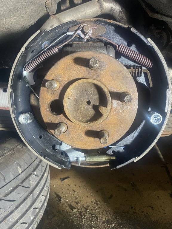

I replaced all brake shoes, drums, small bits and pieces in de brakes, wheel cylinder, brake lines, master brake cylinder. I've upgraded the brake cylinder to a double brake line version, the original had 1 connection and I wanted that more modern.
So now, when the engine is off, I have quite a sturdy brake pedal and it feels decent. When I start the engine I lose all pressure, i hold the pedal the same when starting but the pedal goes to the bottom.
When I shut the engine down it regains pressure. I've checked for leaks, I've bleeded the brakes, checked the fluid level, I've checked the booster valve on the brake booster and I've checked the vacuum from the engine to the brake booster.
When I start the car with the vacuum disconnected it keeps it's pressure, when I connect it loses power.
My guess would be a bad brake booster, but I would like to hear some of your input as this is my first American classic. I used to work on old European cars.

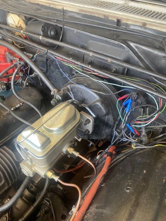

View attachment 730632 (and yes, the wiring looks terrible,I had to find some issues).
Thanks for your time and greetings from the Netherlands.
