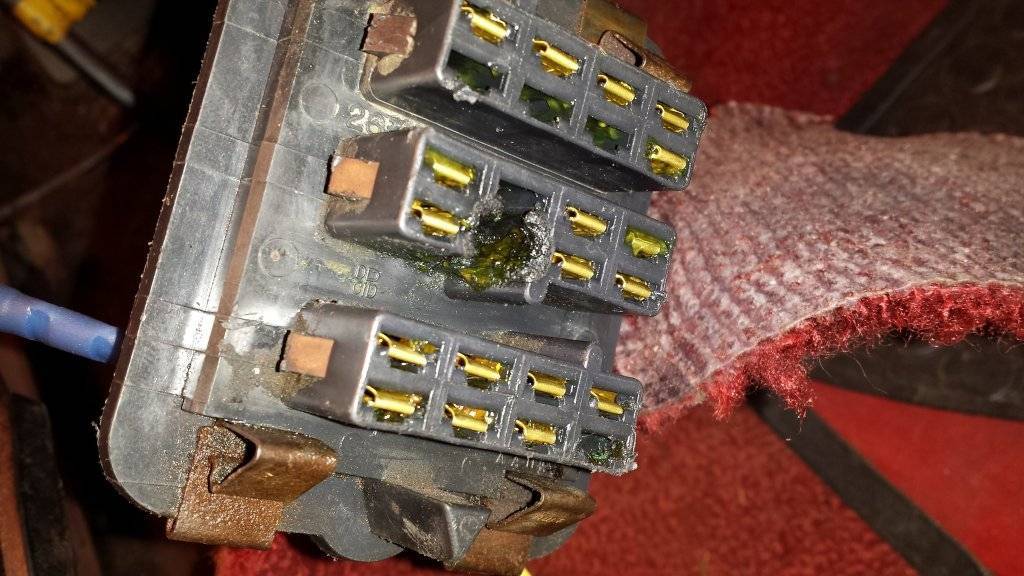

Here is a photo of my firewall block. it was pretty nasty and the slots where the main amp gauge wires goes in & out were melted so I moved it to an unused slot when rebuilding the harness

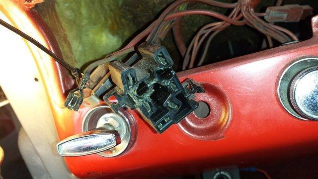

not to hijack this thread but everyone should be checking their head light switch out as well.
This was mine when I checked all the connections under the dash

Here is a photo of my firewall block. it was pretty nasty and the slots where the main amp gauge wires goes in & out were melted so I moved it to an unused slot when rebuilding the harnessView attachment 78257
And that right there is the reason that everybody here should do the amp gauge bypass mod....
