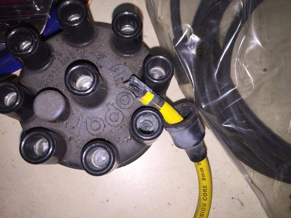

So I've been experiencing on and off driveability issues this past few weeks.
I found this last night. i had thought to myself for the cost to get a Distributor cap and rotor as a just in case.
I has asked to ignition wires too but the desk jockey got confused and didn't order them in for me. I wish he not gotten confused..
I found one of the lugs in the cap had fried along with my beautiful Excel wires.
I tend to keep things so I rummaged through my spares and found a decent looking replacement to try to sort out the engine and discovered I have a vacuum leak near the back of the engine area. I think it may be a defective/worn out PCV valve...
So check it out below here.
