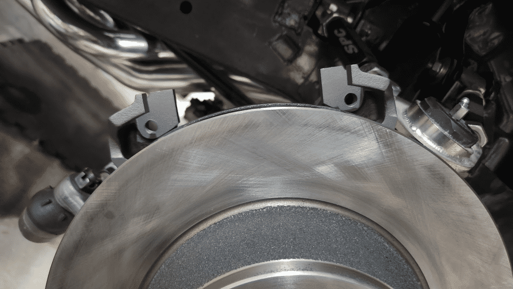

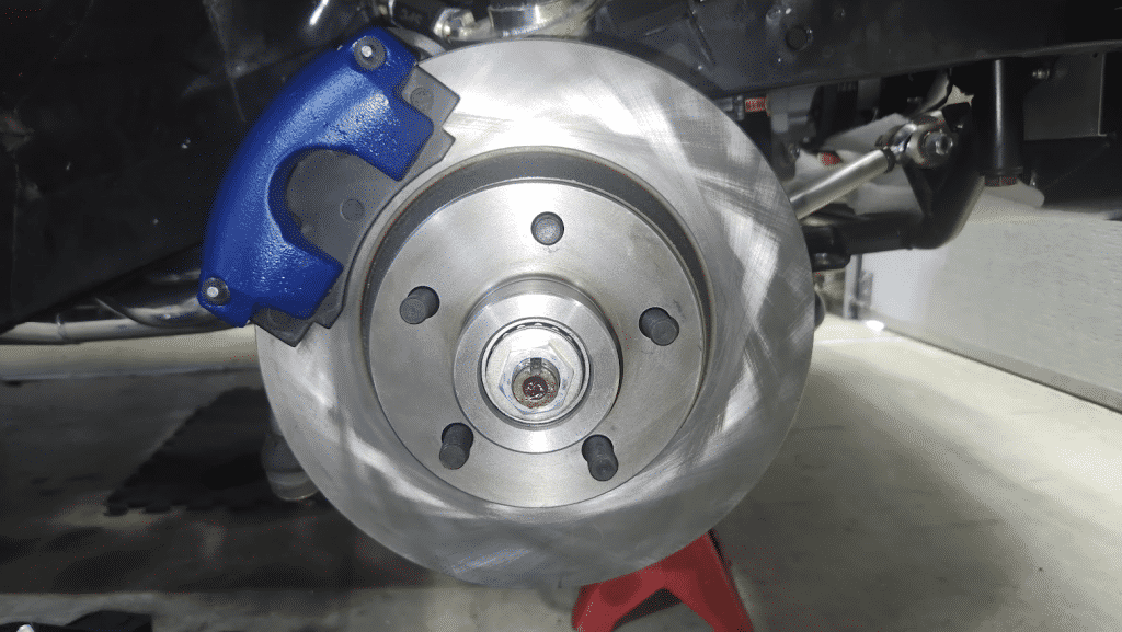

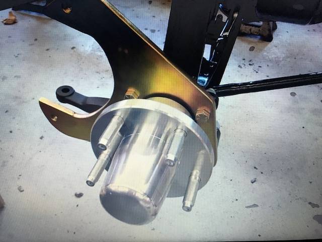

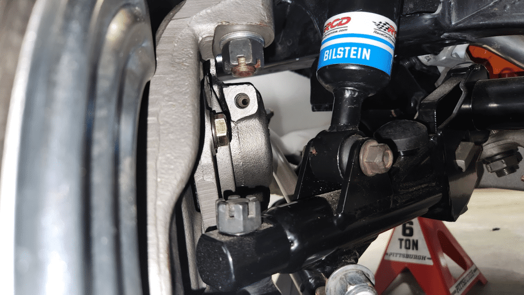

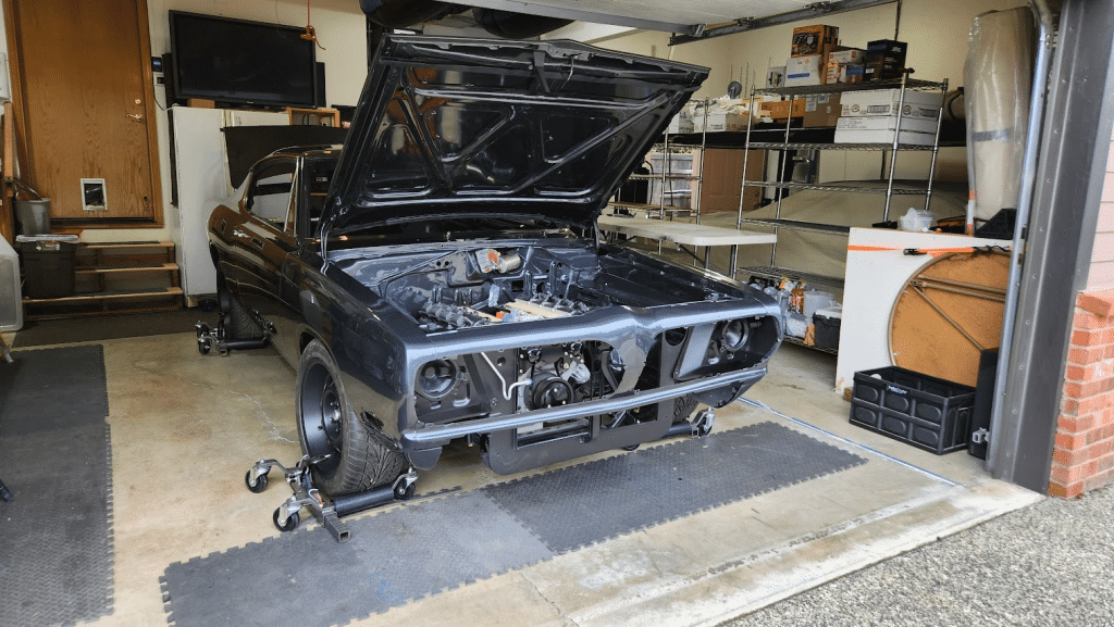

Building a 69 Barracuda g3 hemi swap resto-mod.

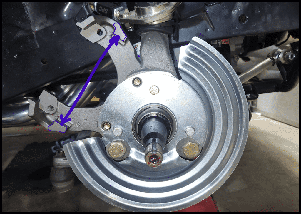

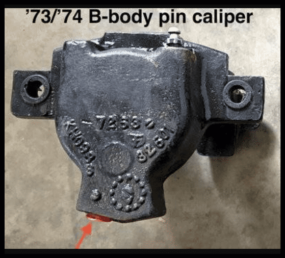

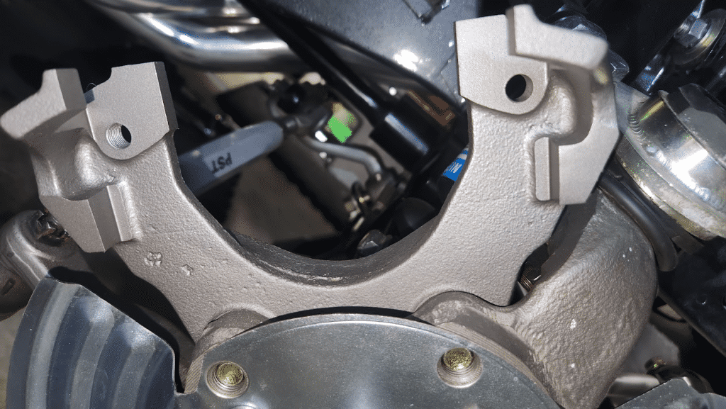

Car has 73-up, front disk spindles, New Yorker/Cordoba Pin on Calipers/Brackets and 11.75" Rotors
Question is, will any of the big C-Body (1.25" thick) front rotors bolt directly to my 73+ A, B, E, body spindles?
$64,000 question: Will either of these Front Rotors work on my NON C-Body Spindles? Or other C-Body 1.25" thick rotors with 5x4.5" bolt circle?

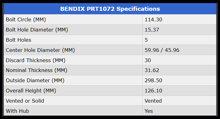

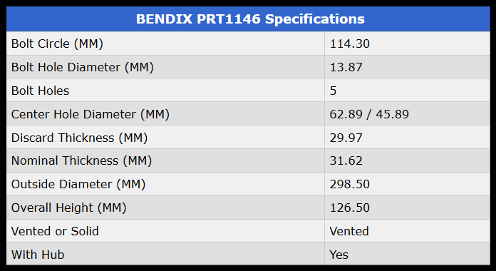

For 1973 I see Bendix PRT1072 listed as 5x4.5" bolt circle.
For 1974 there is Bendix PRT1146 also 5x4.5" BC. 1974
The project car.
TIA.
