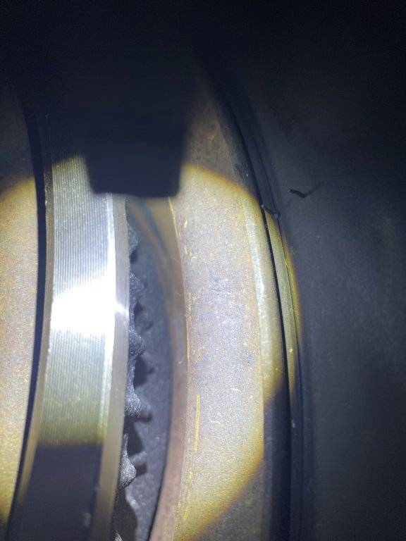

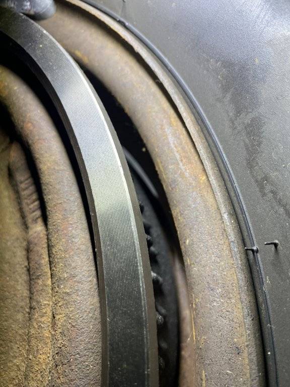

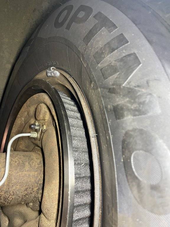

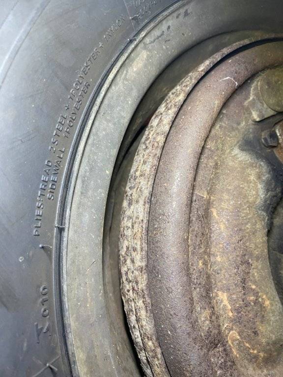

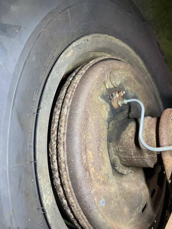

I purchased rear drums and shoes for my 1967 Plymouth Fury from Craig @mobileparts at Carlisle. Apparently the correct NOS 11" x 2" drums are hard to find. Craig only has 1 left. We decided to experiment with the fitment of C2955 for a 1969-1972 on my 1967 with 14" wheels. C2955 has fins on the drum, thus creating a wider/thicker outside diameter.
I was able to test the fitment last night and it looks like it's going to work. There isn't much room to spare, but there is a slight gap all the way around the drum, between the drum and wheel. I tried getting pictures but it was difficult to hold the flashlight and the camera and capture the gap/fitment without creating shadows.

Looks Good !!!
