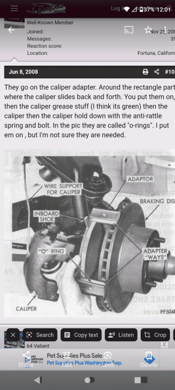

Yesterday at 11:03 PM #4 F Fred A Member Joined Oct 23, 2021 Messages 135 Reaction score 5 Location Michigan There are no sliders
Yesterday at 11:04 PM #5 F Fred A Member Joined Oct 23, 2021 Messages 135 Reaction score 5 Location Michigan Fred A said: There are no sliders Click to expand...
