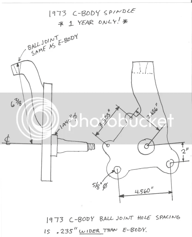

This page shows some measurements between E-body, C-body and 74-78 Formals, and the bolt spacing differs - so a Formal bracket/caliper is a no-go for a straight swap.

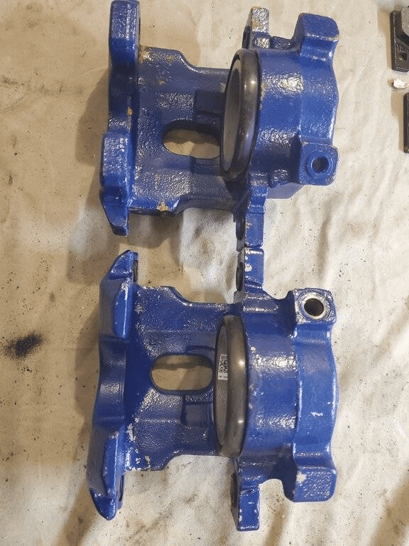

While I would want to have these in my hands to really measure, it looks to me like it's the same overall width with a different inside width. Judging from these pics, there's enough material to cut 1/4" off with no problem. It looks like they are the same basic casting.
I think that photo is misleading in its perspective... and would respectfully siggest the B body casting is narrower.
I dunno...
As i said, I'd have to have one in each hand to really tell, but I think it's worth looking at. Another pic from that thread.
