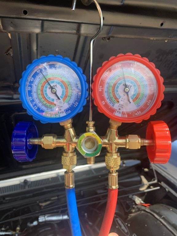

I’m trying to figure out if my a/c is running optimally or not. I have a 66 New Yorker with a gen 3 hemi. Using the compressor that came with the engine, new oem tube style condenser, new drier, new expansion valve, new evap core, and new custom a/c lines. Playing with r134 pressures and fan placement the best I’ve see come out the center duct was 50 degrees at 55-60 mph stop and go traffic has it at 53-60 degrees. This is at low 90s ambient.
Is this about what I should expect for my setup? It’s ok for the front seat riders, the kids in the back will not enjoy it.

What are the high and low side pressures running as well as duct temperature when you have the a/c on max cool, fan at full blast, the windows down and idling?

90 degrees ambient 50 percent humidity
This is at idle. Vent temp 62 sitting directly in the sun
At 2k rpm low side sits 25-27 psi vent temp 58
